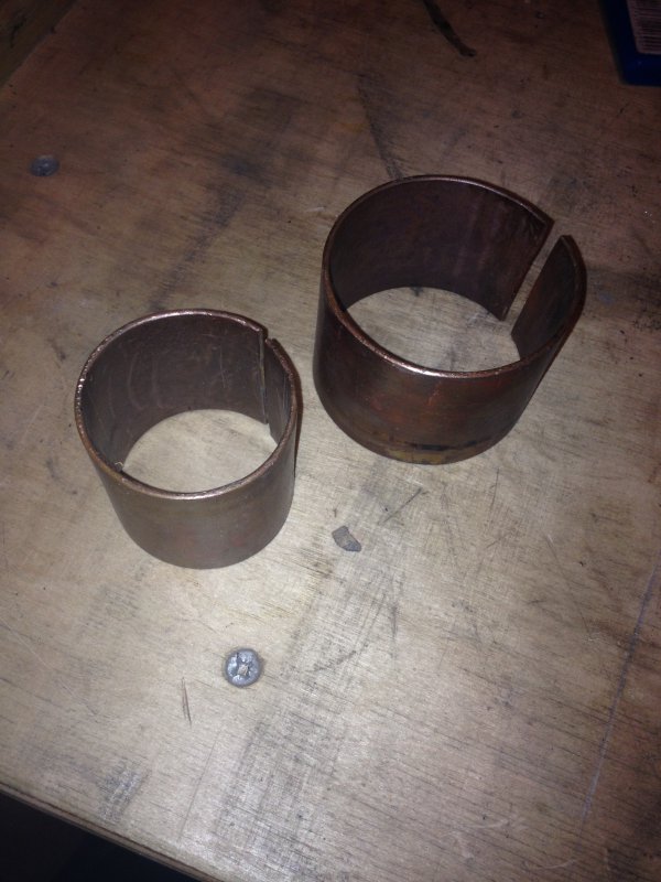

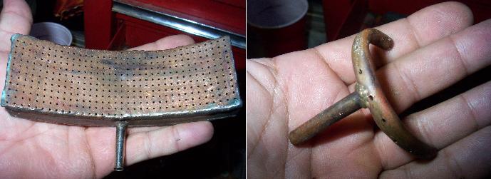

If you clamp a copper backing bar tight against the back of the joint you wont really need to purge, I do it all the time, this tank here is 1.5mm stainless I've used pickling paste to clean it but there is no sugaring
