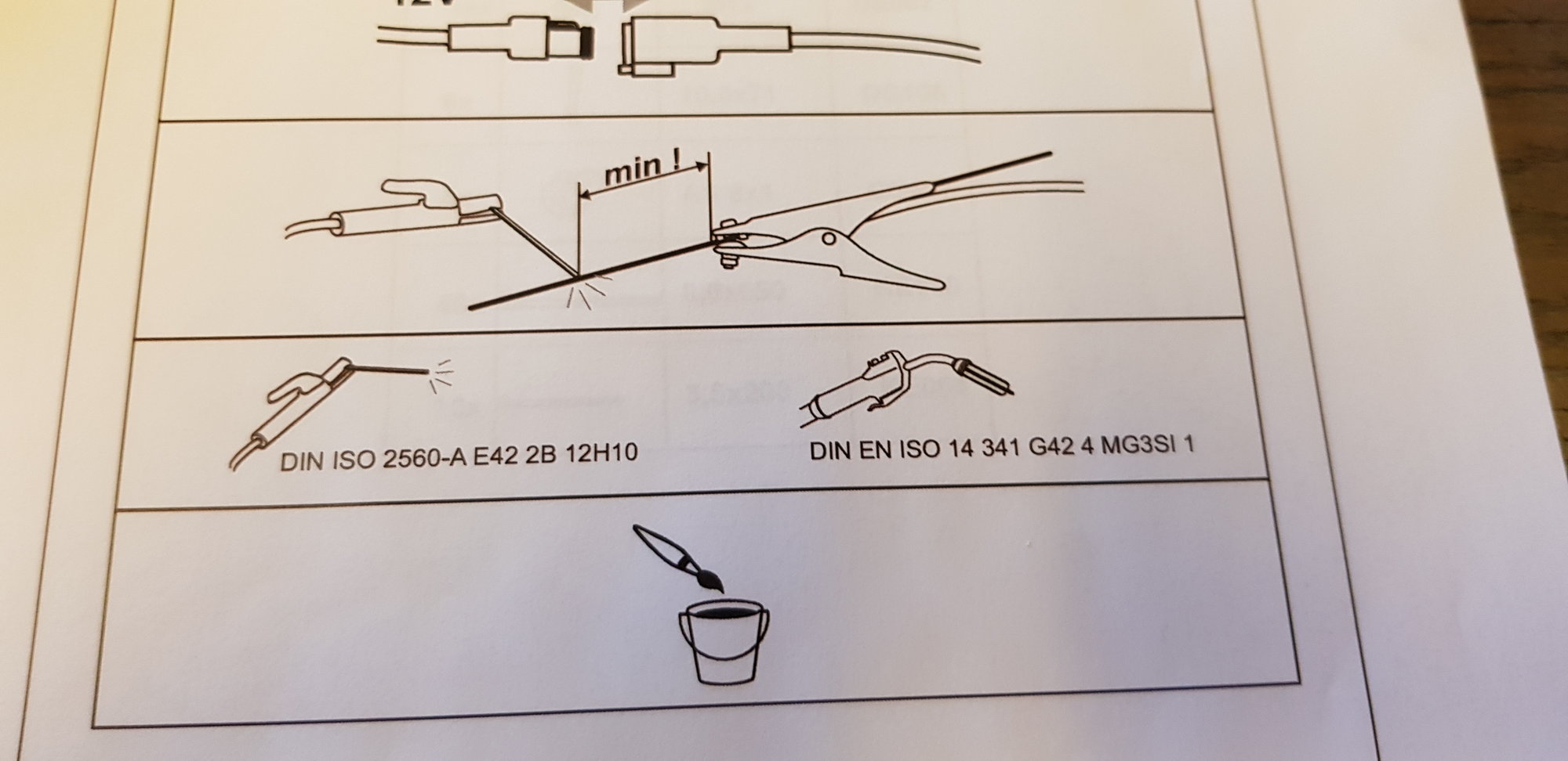

SMAW/STICK:
Electrode | 420 MPa Min. Yield Strength | Min. Impact 32J @ -20C | BASIC | <= 105% Recovery | Max. Diffusible Hydrogen Content 10ml/100g weld metal
So is that a standard E7018
Just check the ISO 14341 spec on the box, as 7018 comes in many flavours even from ESAB there’s about 7 different electrodes all 7018 but some don’t meet that spec.Thanks Brad, wouldn't normally use anything but a well know branded rod
