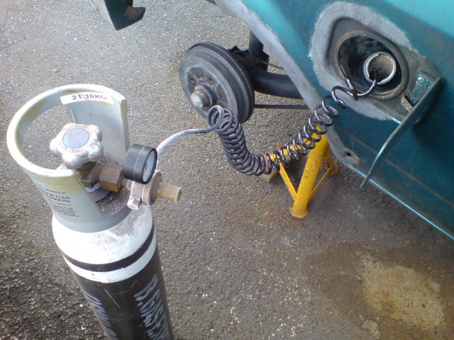

as long as your happy that's all that counts no big dealI was welding close to my petrol tank today. I know it doesn't leak, the vent and fuel hoses were blocked and then the tank was purged with CO2,
now I'll wait for the replies to say how reckless I am.![]()
