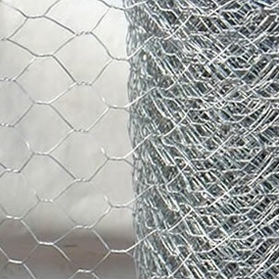

Is it possible to weld chicken wire to a thicker wire frame?
welding with gas will be no problem and the galv will burn strait off
You can do that kind of thing quite easily with a Mig.
Set the power so you just get penetration on the larger piece.
Start the weld on the larger section, give it a second or two to stabilize then slip the weld pool onto the wire, see it start to melt and stop.
Practice a few times first to get a feel for it.
Will drive you crazy at first then become easy.
