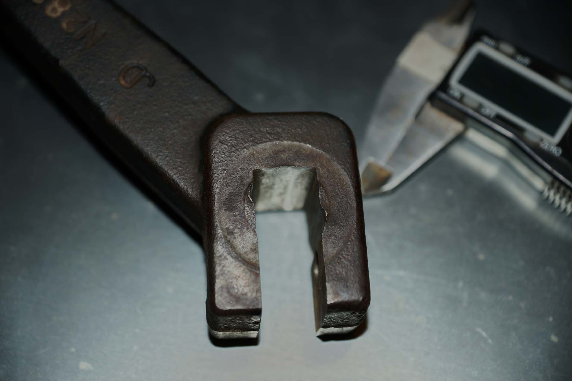

Hi all.
I need to build up ~1mm of metal ~3.8mm wide on a cast part, the wear groove is 30mm long but I don't need to fill it all to get out off trouble.
Current suggestion is to heat until about 60-80 degrees then tack with mig and leave them in sand to cool slowly.
Is that the best option?
