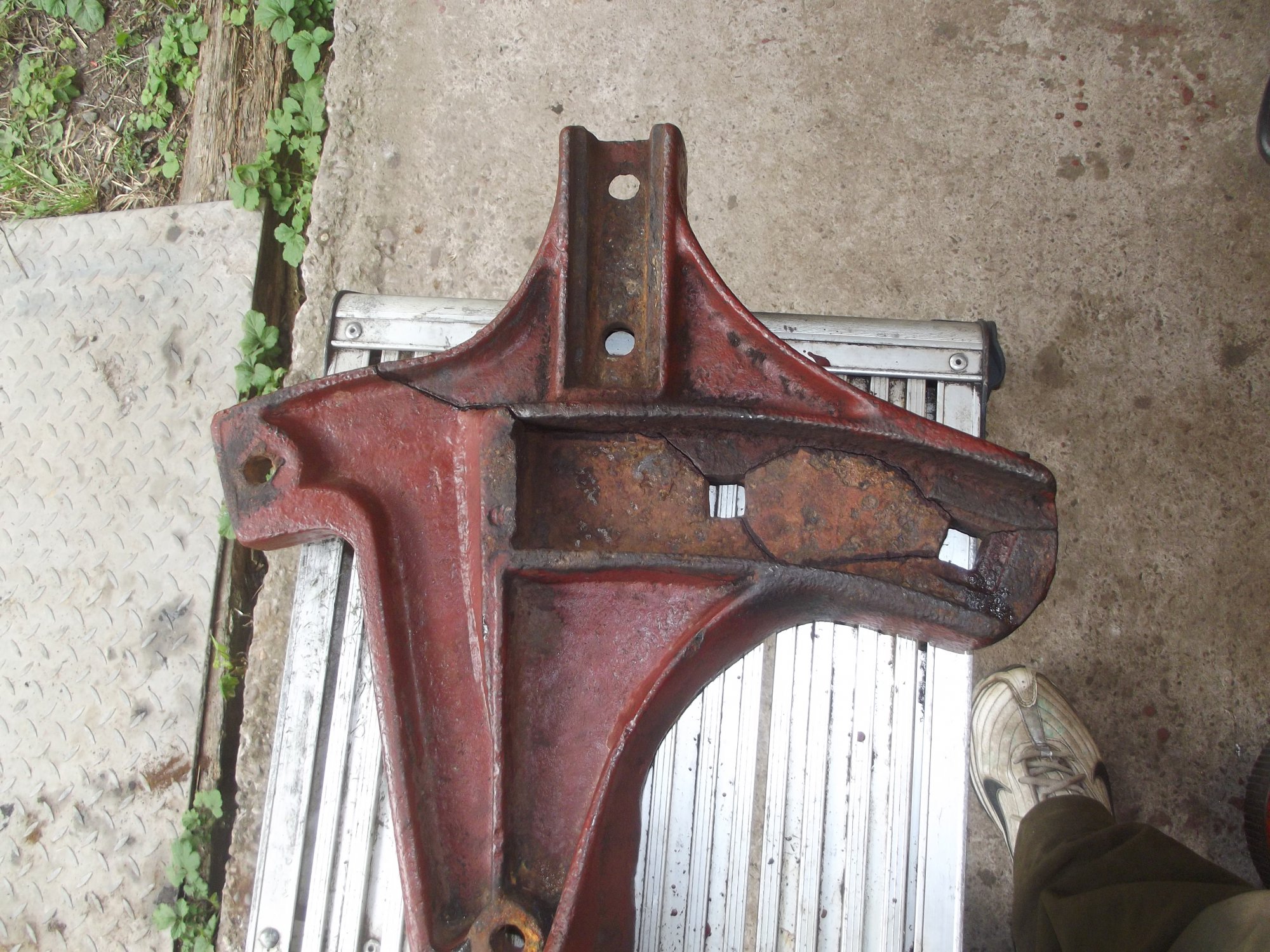

I would vee out the cracks on the other side and also braze them. Clean besides the cracks well and braze at least 1/2" wide. I don't think braze will stick to where there is nickel.
Hi Bsmith, thanks. I am planning on doing just that. I'll probably TIG braze it because I haven't tried that yet!
