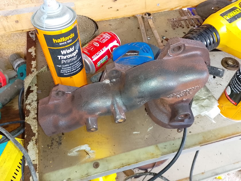

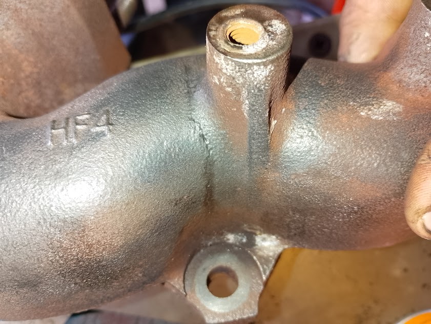

I got caught out with that, can't remember what car but just assumed it was cast iron from the look of it...tried to mig weld it after a preheat with a torch and was going to use the torch to allow the cooling...but it cracked as I was welding it, worse than the original crack, then I found out it was some weird stand alone stainless blend that wasn't weldableI have miged cast a long time ago, but was using an old oven to get it above 200c.
using a sand bath to slow the cooling is what i was told helped.
Think that if you can get it bronze TIG'ed that seems to be the most favoured.
Some manifold on modern cars look like cast iron, but they are a form of stainless.
