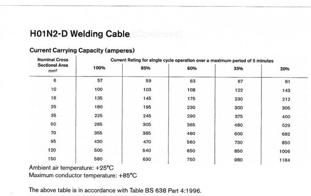

does larger than necesery cable draw current from the set??
i know if the cable is too small it will warm up
reason i ask is my new 200 amp set turned up with a 16mm earth lead and it was warming when welding,so rang supplier and he sent down 50mm lead
the mma lead is 25mm so i asked for a 25mm earth
isnt 50mm suitible for like 400-500 amps
no point in having one larger than the other as its only as good as the smallest cable
