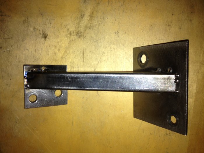

I am building a jig that consist's of 2 pieces of 30x30x3mm box welded at a perfect right angle ( L ). It is important to get this bang on and I wanted a little input from people on how they go about keeping the parts square whilst tacking up, and then fully welding.
My pieces come off the saw (Either a band saw, or Evo Raptor dry cut cold saw) near enough square, but not quite as I haven't had the time yet to tinker with them to achieve perfectly square cuts.

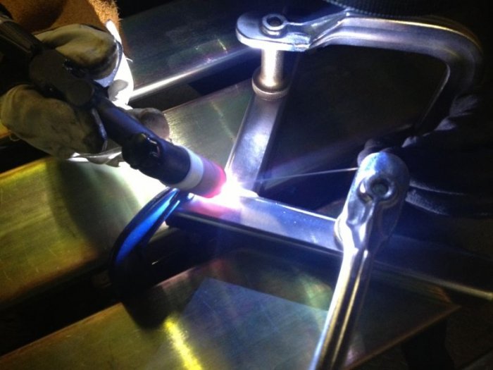

I had a go last night; clamped the 2 pieces down with 3 clamps to the table, adjusted for square and put a tack on the outside corner. Then rotated the table and tacked the opposite corner through the slit, then back to the other opposite corner etc etc till I had 4 tacks. Let the piece cool down and the removed it, checked for square - fail...
So then I put it in the vice and "persuaded it" back to square, re-clamped and added more tacks in the middle of each flat side, checking for square after each one. Managed to get a total of 8 tacks on this thing now, and at present its still square but I am worried that when I weld it up it will pull way out and wont be so easy to "persuade" then.
My plan now is to weld the left and right sides first, then the back edge, then lastly the inside fillet.
So, my question is, is there a better way than the above, or should I just aim to cut / linish my parts perfectly square before I weld them to make life easier?
