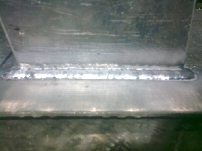

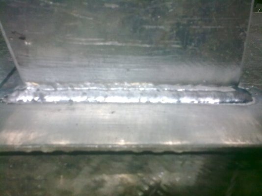

Thought id share my progress today with welding aluminium. At my work we do a lot of mild steel fabrication and sometimes stainless steel, but often struggle with aluminium repair jobs. I got a ali roller off ebay a while back for my murex tradesmig 260-1 mig, but havent had the time to try it out till today. I usually use a 5m MB25 torch for steel work, but ive got a dedicated 3m MB25 torch setup for aluminium. Anyway the roller made a huge difference, much smoother wire feed, no birds nests, and a very smooth weld pool which was easy to work with. Id deffinately recommend to anyone doing ali welding with a mig, and for the price (£8), great value for money. Below should be a pic of how i got on.
Its a multipass fillet on 6mm ali chequer plate, prob about 160amps or thereabouts. 1.0mm wire.
