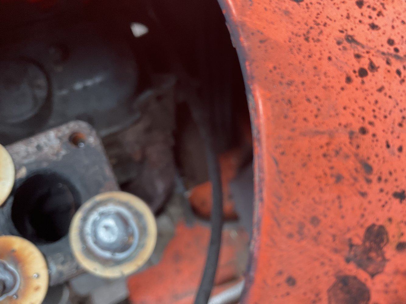

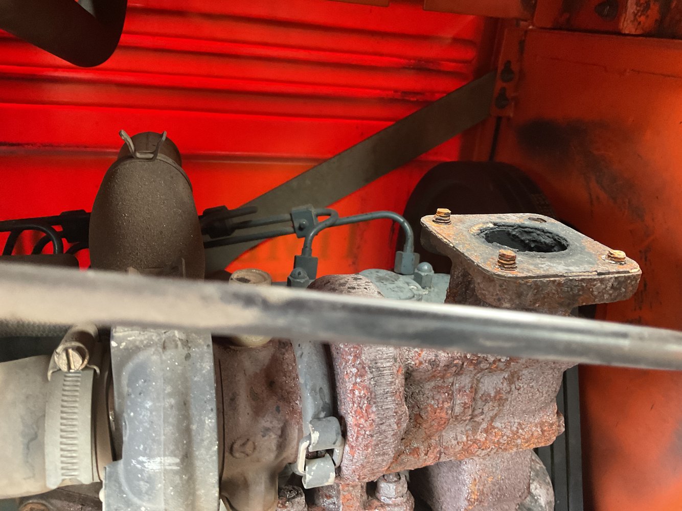

I come across this all the time at work (steel fasteners corroded into aluminium).
What you see on YouTube doesn't relate in any way to real life unfortunately.

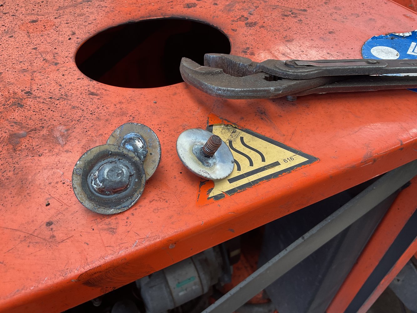

I've been meaning to look into some core drill like cutters to go around 8mm studs, so you can cut the stud our of the head and still have enough meat for a Wurth Timesert repair.
You can't do it in your situation by my preferred method with exhaust removals is to cut the nuts off and try and salvage the studs, 9 times out of 10 that's a successful repair.
The problem is when the customer has had a go first and snapped 3 or 4 off flush with the head..
