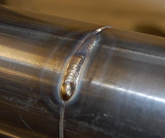

S squazy84 Banned Messages 730 Apr 17, 2011 #1 Im welding up a stainless downpipe for my car and im wondering if 2.4 mm filler rods from weldequip would be more suitable than the usual 1.6 filler i use, or easier to control for my retarded left hand

langy langys rodshop Messages 6,087 Location London Apr 17, 2011 #2 I use 1.6 with 1mm wire, just right
langy langys rodshop Messages 6,087 Location London Apr 17, 2011 #4 1mm or 1.6mm is fine. squazy84 said: so order the 2.4 yea? Click to expand...
R Rick Member Messages 639 Apr 18, 2011 #5 You'll struggle to get the 2.4mm in there. I'd use 1.6, although if your actually using 1.6mm pipe (more likely) i'd use 1mm. Pic shows 1.6mm with 1mm filler. 1mm filler.jpg 29.1 KB · Views: 540
