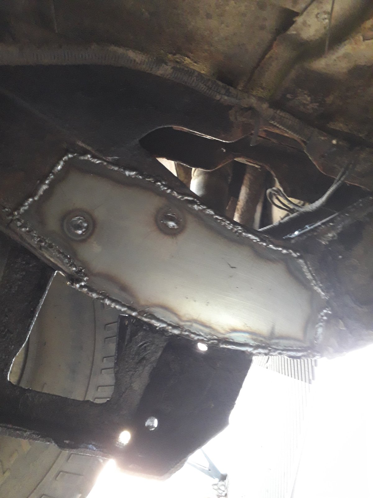

You'd be better off getting a gas mig and shielding it when working outside. Make sure the minimum setting on the welder goes down to 30 amps or so if your going to weld 1mm sheet steel / LR rust...
What do you mean exactly by shielding it? Literally putting up a board or something to stop any wind?
