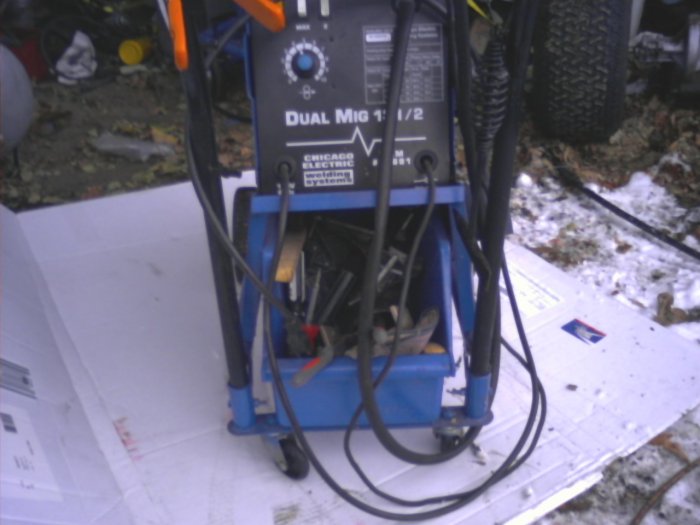

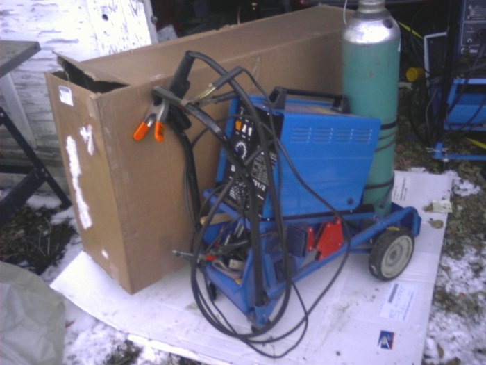

Naturally the first thing I did was to make a cart.

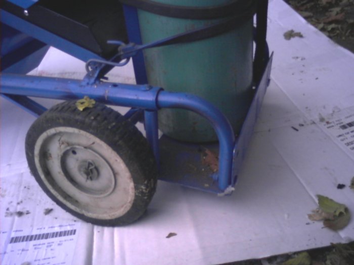

I found a wheel less sack truck in a dumpster put lawn mower wheels on it,a few chunks of angle iron and a fridg. drawer ended up with this.
I balanced the weight over the back wheels, with enough overhang, so it wouldn't tip.
Cheap way to make a cart, even if you have to buy the truck new.
