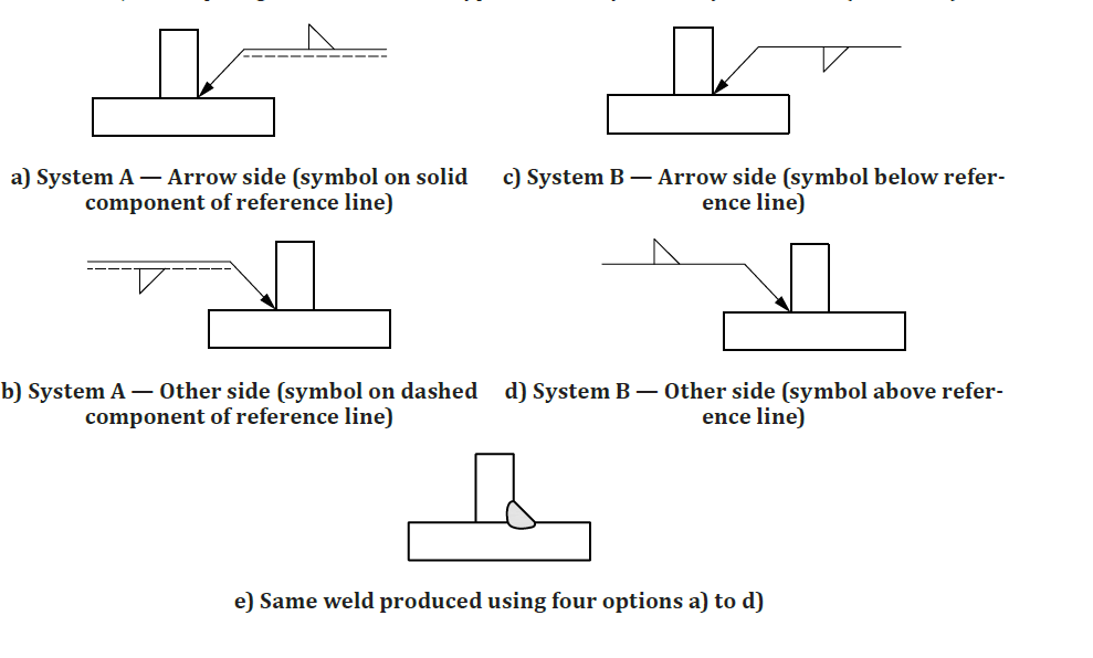

Trying to get my head around welding symbols again.
Three questions:
1. Am I right in thinking the dashed line under the reference line is a UK / ISO standard and not AWS?
2. A Symbol above the reference line (if the reference line has the dashed line under it) means the weld is to be placed the same side as the arrow?
3. A Symbol above the reference line (if the reference line has no dashed line under it) means the weld is to be placed the opposite side as the arrow?
