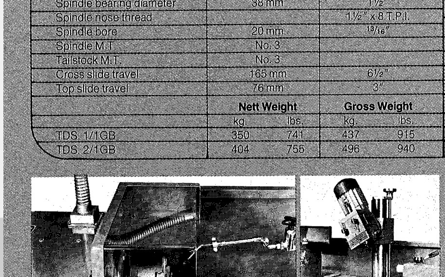

Just found this which may be the same lathe,
http://www.denfordata.com/pdfs/Viceroy-TDS1-Metal-Turning-Lathe.pdf
says this at the back.
So not far away but @Seadog is closer![]()

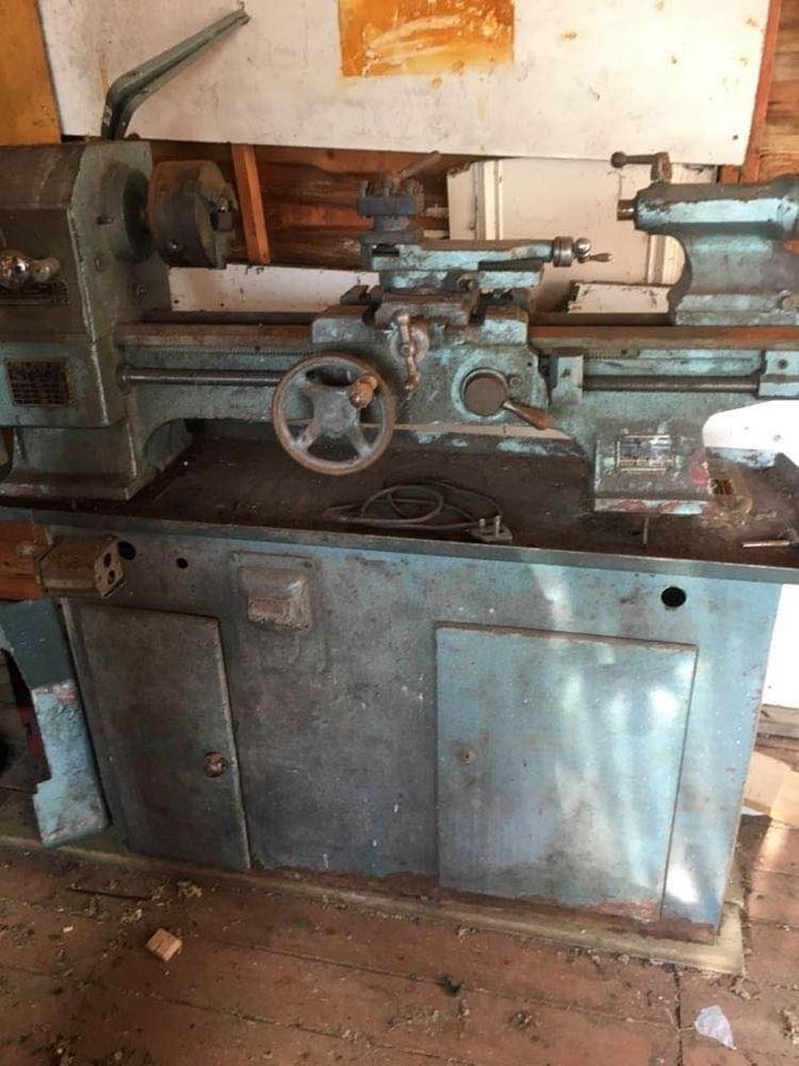

Thread is a few days old yep. But OP still knows nowt lolThey're essentially the same as the Boxfords; just below the splash tray at each end there are 1" holes in the front and rear walls of the cabinet intended for threading lengths of pipe through to be used as lifting handles. Four average blokes or two chunky monkeys can shift one of those about easily enough.
Can be slung from an engine crane or else the lathe can be separated from the cabinet if you disconnect wiring, belts etc. - although you'll nead a sealant on reassembly.
