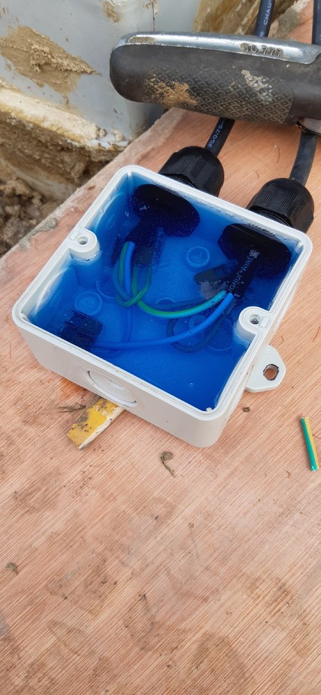

Looking for some advice on any products which may help me with making some electrical junctions waterproof.
I have 6 outdoor lights, each connect into the supply cable via a wiska junction box. The supply cable runs in and out of all the boxes (excluding the last one in the chain), into a junction block, and the supply wire to the light then is wired into the same block.
All was well for a while, before I started getting spurious trips. I checked the boxes and sure enough they have got moisture in, and are causing the trip. I think this is because soil has mounded up around them (not covered, just around the bottom third), and I guess the moisture is just getting in over time.
Anyway, I would like to make the junctions waterproof - I've looked at wiska gel, but it seems pretty pricey. Is there any alternative products which may be cheaper?
My other option was to try the wago gel boxes - does anyone have any experience of them?
Or has anyone got any other options I should consider?
