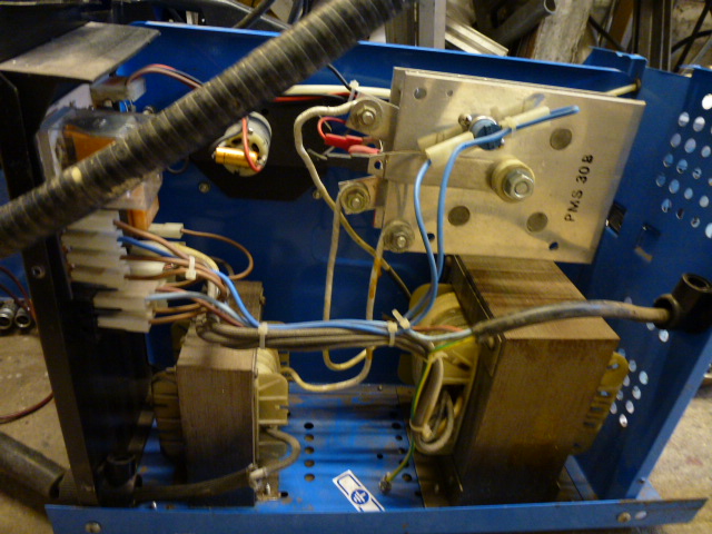

I'm going to use an old copper cpu waterblock thermal adhesived to the transformer (somehow, I havnt even looked inside yet).
I'll plumb that through 10mm tubing into the wire feed area where it will run through an eBay special £9 brushless water pump, and into a range rover classic air conditioning evaporator (copper tubed as you can't use ally and copper in the same water loop. It shouldn't even need a fan if I can get the thermal transfer good enough.
I use a 15kg wire reel mounted on my angle iron bracket with scaffold tube to hold the reel. Never had a feed issue since!
I'll update with pics as I start to modify.
