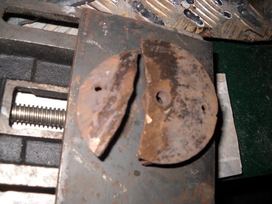

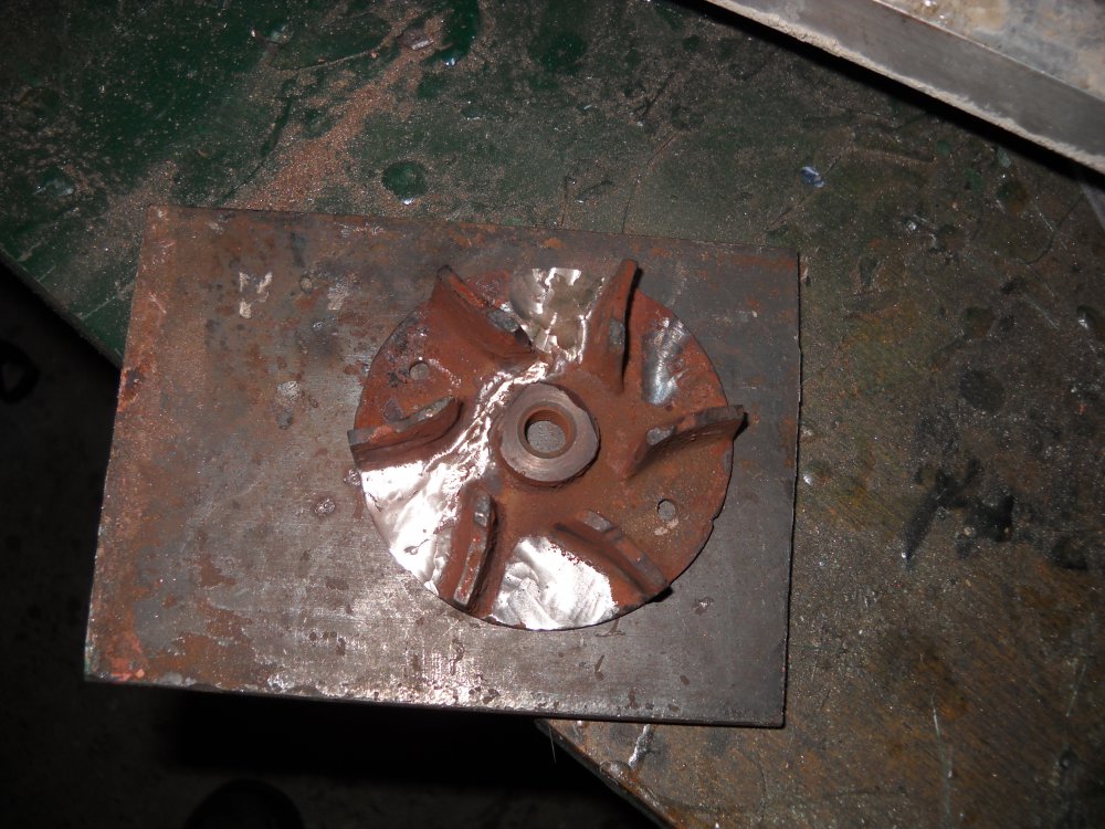

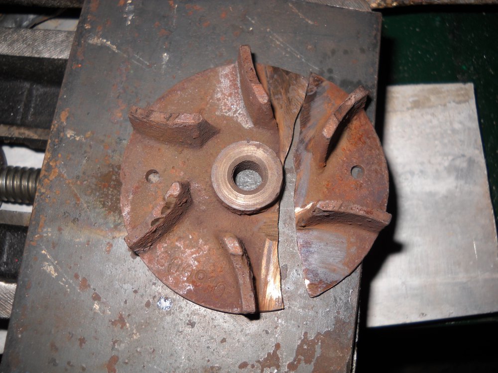

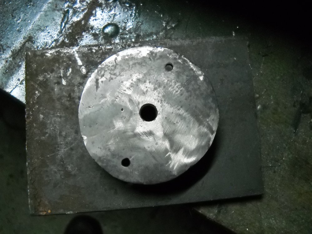

Well I guess this one fit's in here, since it's engine related. I friend of mine rebuilding a water pump from a really old and big diesel driven generator (apparently it's usual too rebuild those, new bearings,seal and so on) broke with at removal. Well the generator needed to be running monday morning at 7 am, that's why he was doing the job on a saturday so he called me up to see if I could weld it up.
I really hate to weld this kind of unknown old rusty cast things , well to be fair I hate cast iron repairs.
I checked and I was out of silicon bronze and also nickel rods so the only option from what I had was the good ole 312.
Cleaned the cast the best I could around the crack, pre-heated to about 350ºC (the first picture is right after the pre heat), welded it up both sides and did controled cooling in sand and inside a oven that I use just for this kind of things that heats up to 250ºC , and I slowly reduce the the temp of the oven over the time. In the total 2hours of post weld slow cooling. He helped me by grinding it up after the cooling and checked for cracks. It was one of the dirtiest cast parts I've seen, a pain to weld, always sputering, although it didn't crack it's the worst looking cast repair I've ever done . I did't take as many pictures as I wanted because all the time the part was of the oven I was in a hurry to finish it so that my friend could finish the rebuild today and enjoy the sunday
