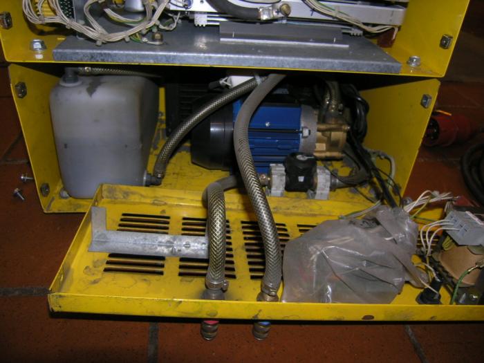

hey,
on my Esab, the water pump gets stuck after a few weeks without use. To get it going again i have to turn it slightly by poking a screwdriver in the fan and then it runs again.
The pump is maybe 3-4 years old, was replaced by the previous owner.
Maybe the coolant is of the wrong type? it looks pretty old anyway. Probably corrosion in the pump or...?
What should can i do about this?

or switch the cooler on every week and let it idle for a while. Another option is to add a timerswitch that switches the pump on and off on a regular basis.
