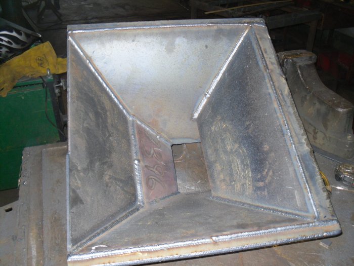

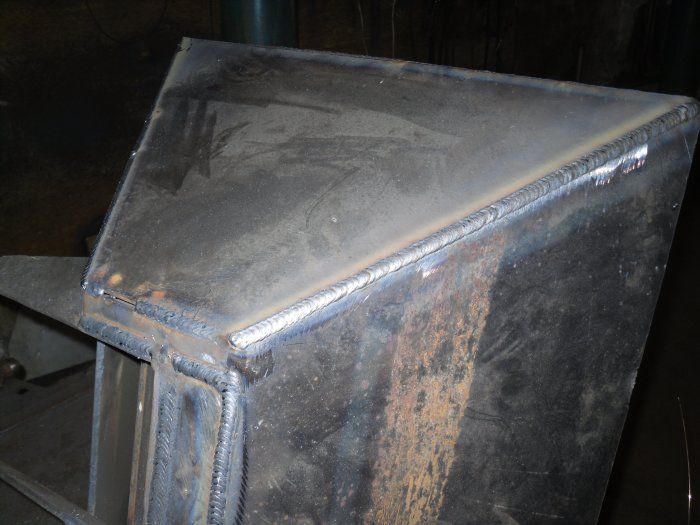

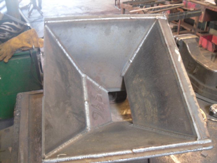

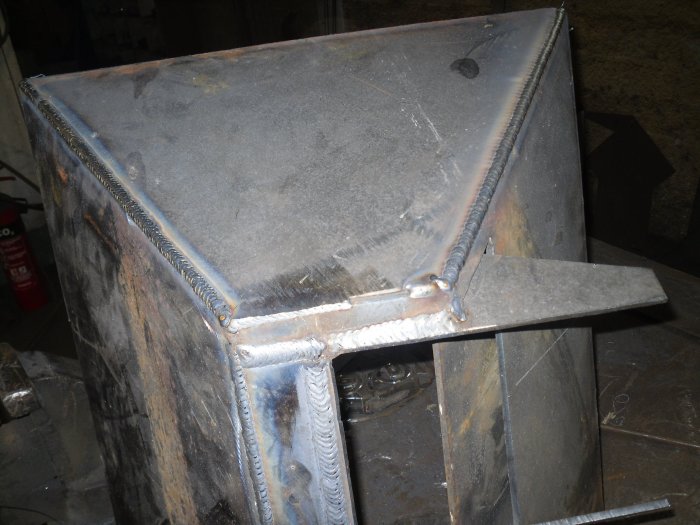

Heres what i do when i gotta work. This is a water jacket for one of our 16kw boiler multi fuel stove. All these welds have to be done uphill to ensure good penetration and to make sure its watertight. When finished i test this under 30psi pressure to make sure there are no leaks. All these boilers are made with 6mm plate
