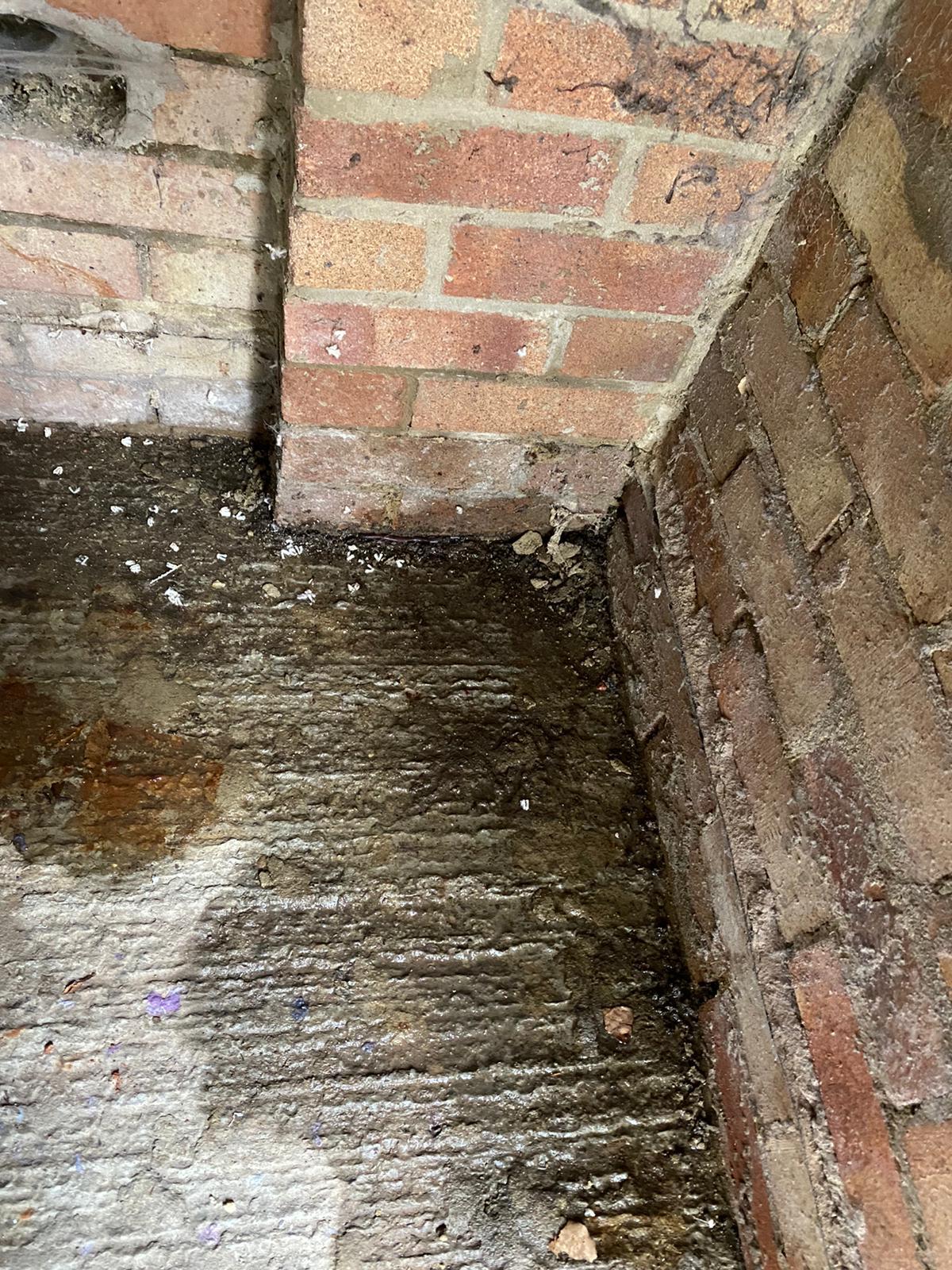

My wifes niece moved into a new house a couple of months ago and today there is water pouring into the rear of the brick built garage. The previous owners have built the ground up against the rear of the brick garage (about 2 ft) and had paving laid with no visible gap. It obviously needs digging out, reinforcing wall, gap with drain, etc but as a temporary fix, could they paint the inside with a tanking or bitchumen paint?
Anyone done this? What would it do to the bricks if they are soaked behind the paint?
