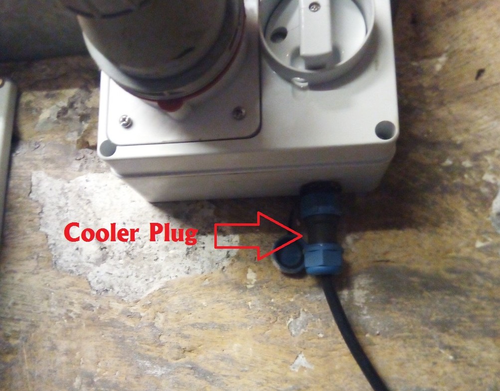

2. It's powered by a plug underneath the welding machine itself... If at a later date my machine goes *bang* can I re-wire the cooler unit with a wall plug and use it on another machine that isnt a Lincoln?
