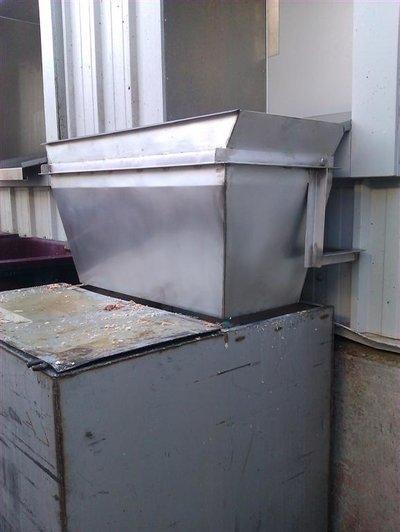

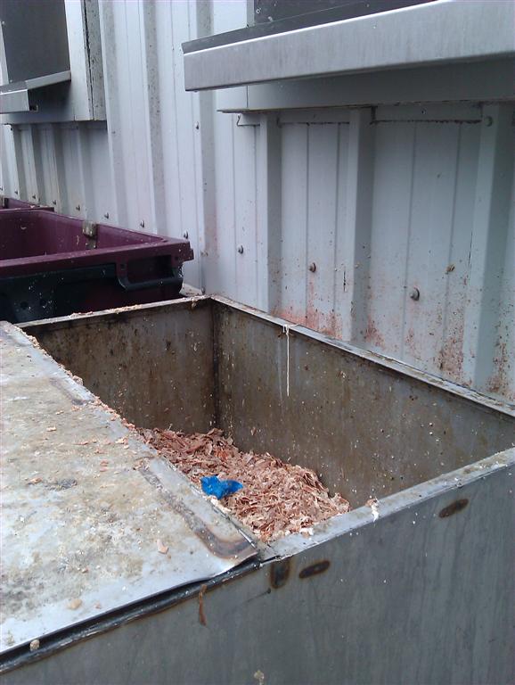

Bit of a rubbish job, this is a food waste bin fed through a hatch from inside the factory by the slide above it, but a fair bit of it ends up on the floor or on top of the bin,

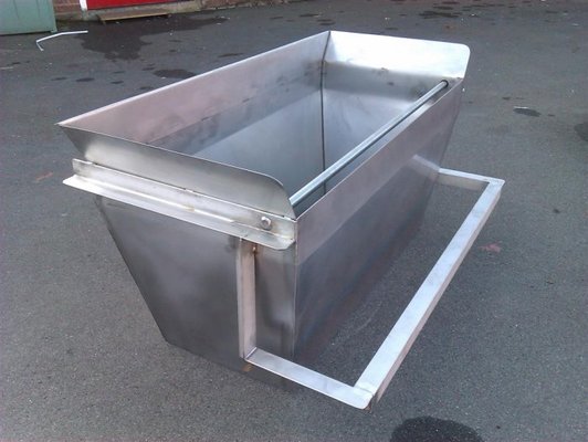

So one suitably over engineered and expensive chute is required, it just hooks on the bottom edge of the folded lip on the slide, and can be easily lifted of for cleaning, not much cleaning up done on this one, just wire brush over the welds and a rub over with an orbital sander to make it look presentable.
