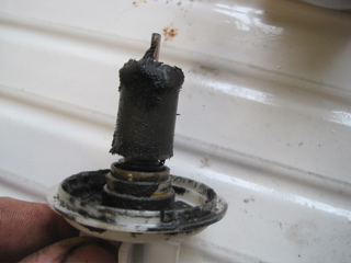

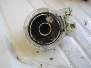

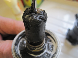

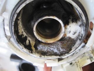

Just had to repair our washing machine again as it was showing a blocked pump. Think this is the 2nd or 3rd time I've had to do it. Metal fillings from my overalls have been attracted to the magnets in the pump and seized it solid! Told the wife to clean my overalls at the local launderette as I thought that was the problem. Well she has been but is still happening so must also be from my cloths as well. Amazing how it happens. Not sure if its a faulty seal around the pump. Its a fairly expensive washer and a decent make, a Bosch. Not really a problem though as its easy to repair and get to. Just wondering if anything major happened to the washer would I be able to buy another one and claim it as a business expense?
