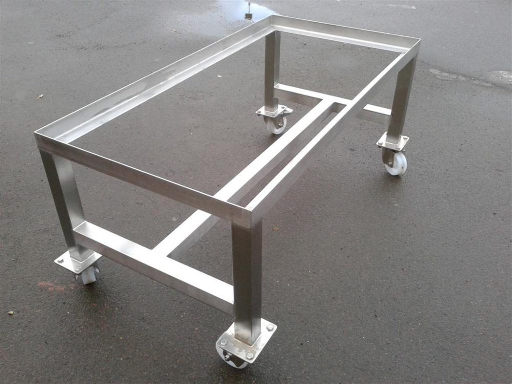

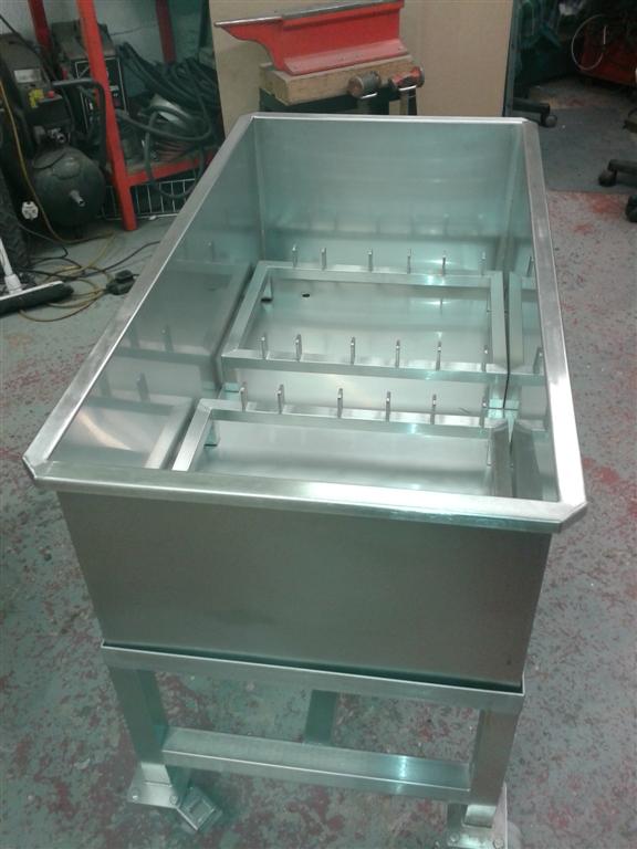

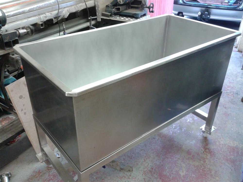

A couple of dip tanks made this week, they are for soaking the blades from a couple of commercial dicing machines, tank bodies are 1.5mm stainless, frame is from 40mm box section with a 40mm angle round the top, the tank then just sits loose in the angle, there is a 1" ball valve fitted for a drain.

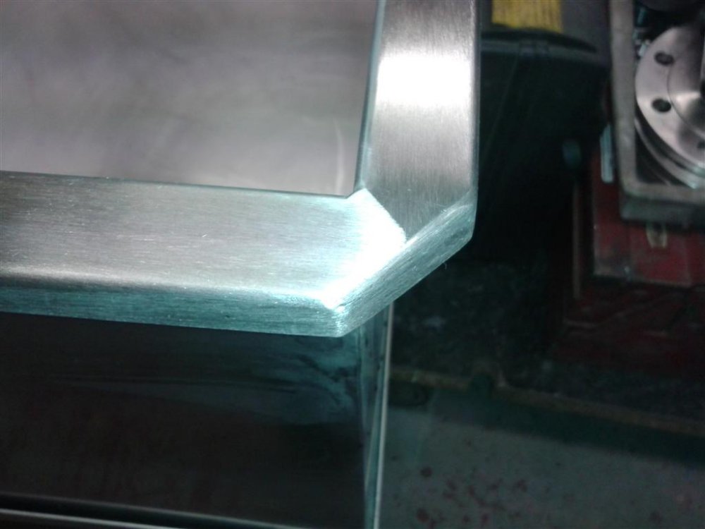

Corners are pieces let in and disguised with a bit of use from a flap wheel

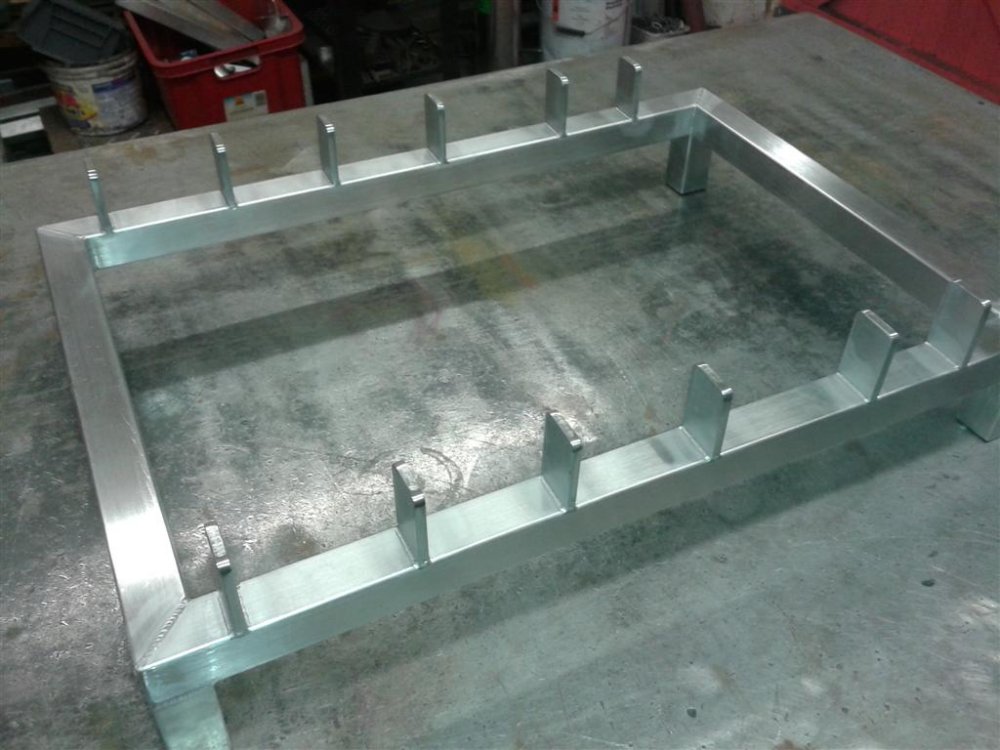

There are 3 of these blade carriers for the larger tank,

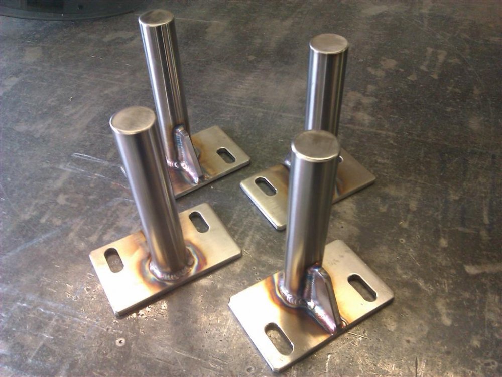

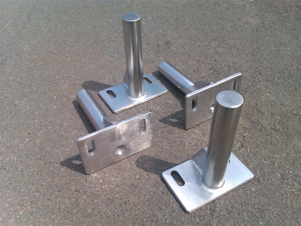

And 2 of these support frames for the smaller one, the parts that sit on these look a bit like lawn mower blades, but a lot sharper.
