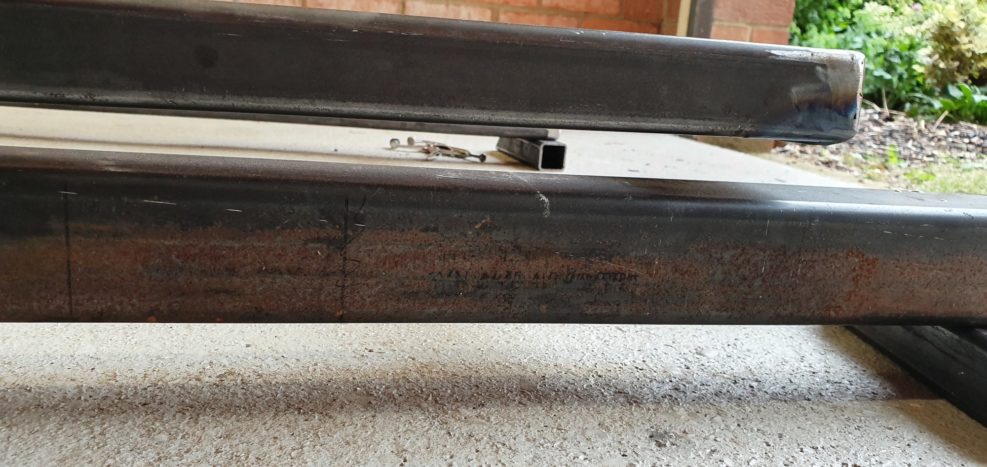

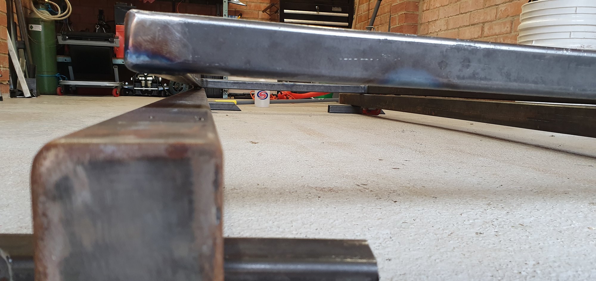

lI have run a weld along the opposite side, and let it cool. Pulled the bow out a treat, Then ground off the extra weld, although I didnt need to as it wasn't on show,
check for square at every tack or weld so it doesn't go pear shaped and can be corrected easily. a load of blocks of wood and a 14lb hammer helps sometimesI ended up cutting and rewelding two of the corners.
Any advice for future jobs to keep everything square when welding?
