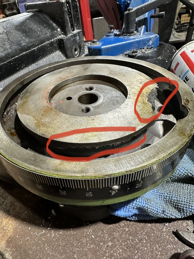

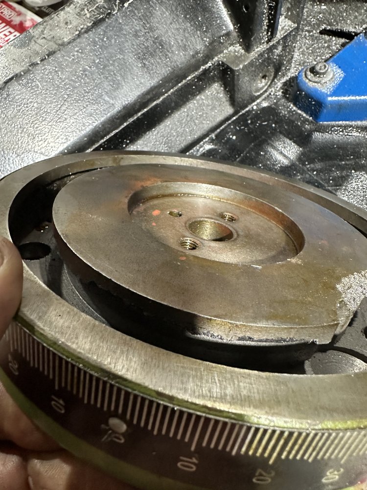

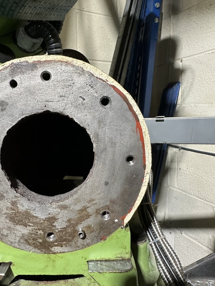

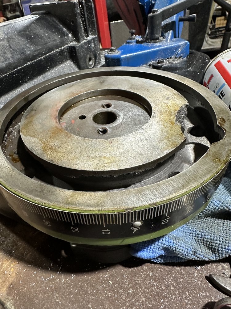

Seems that some clumsy knob in the past has failed to support the head whilst tilting it.
I got the thing to move for machining a bevel on a part I’m machining. It didn’t feel right but had no choice.

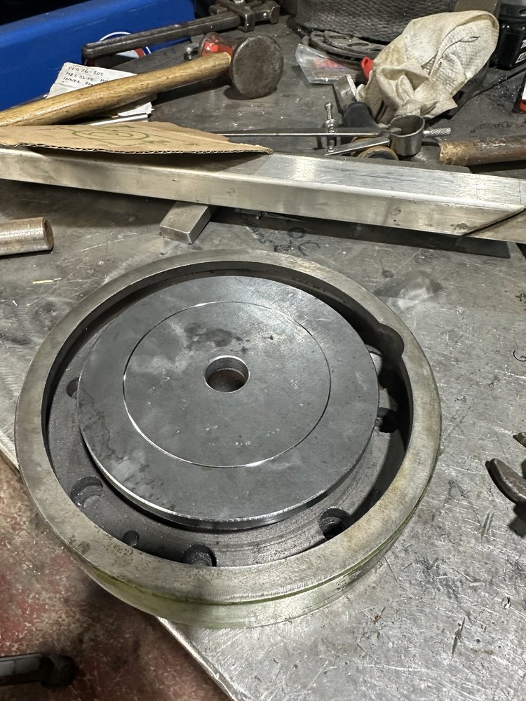

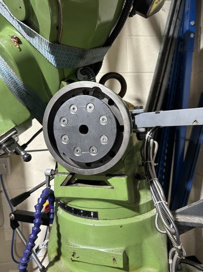

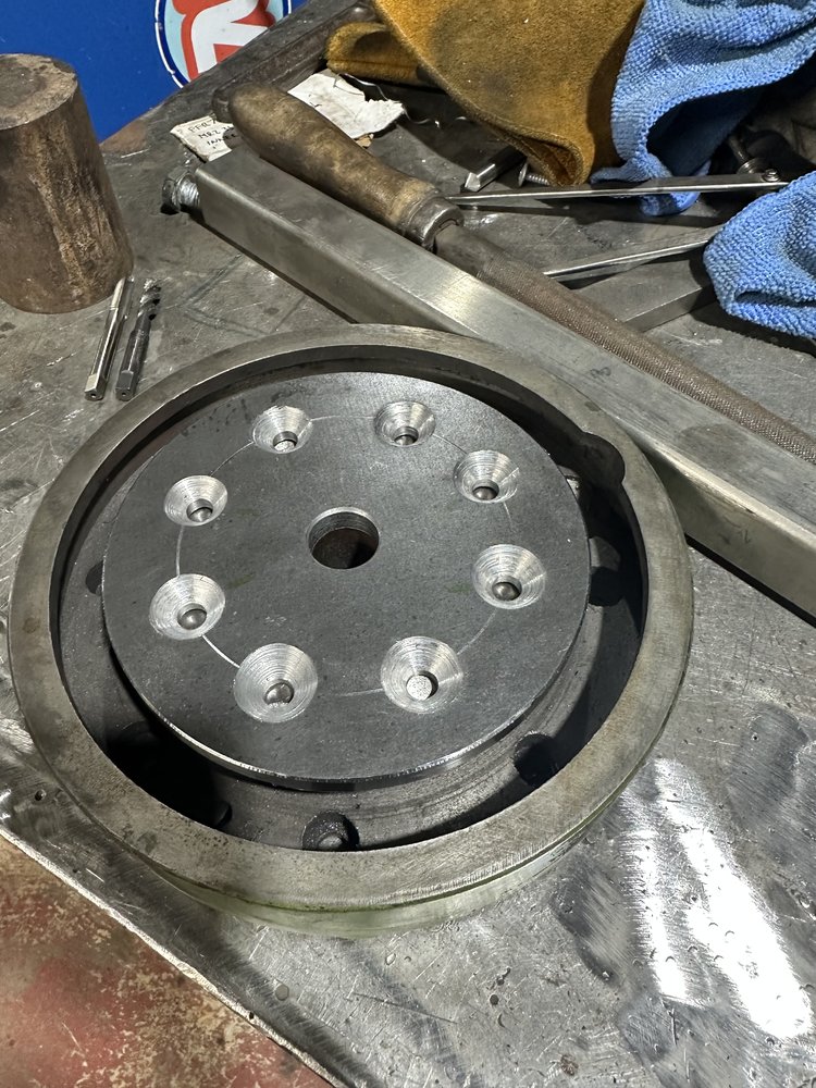

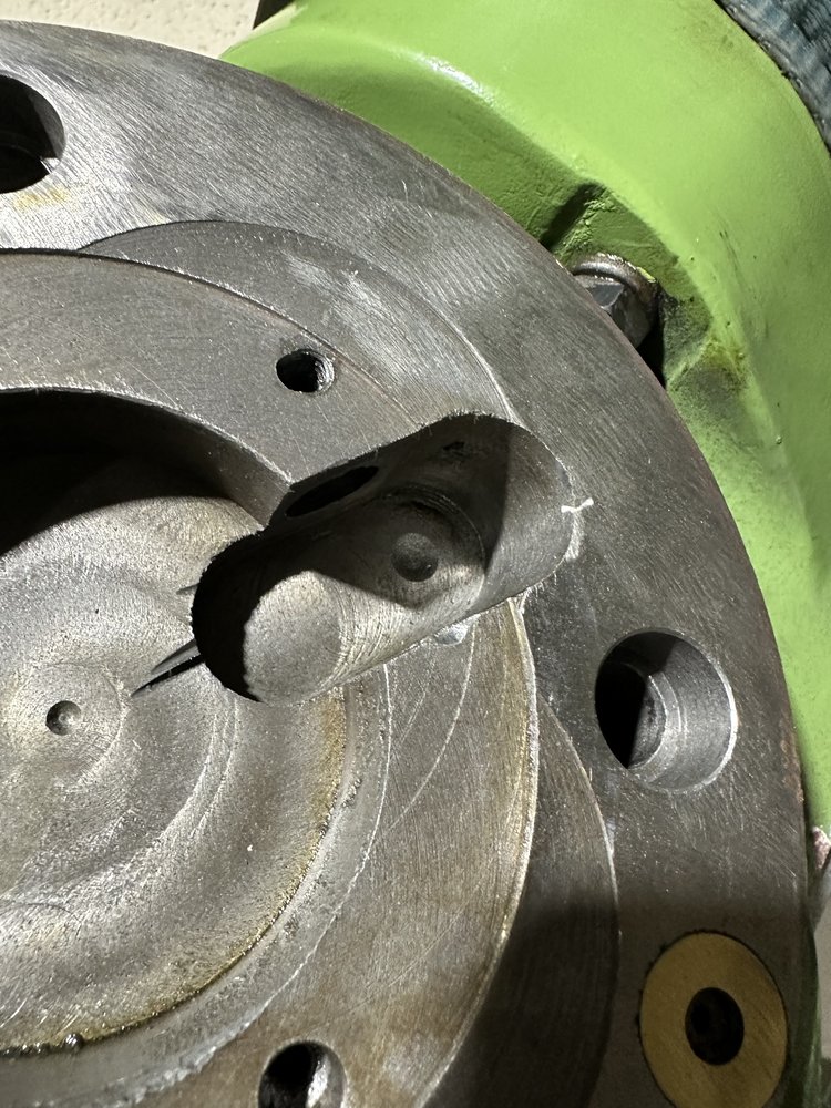

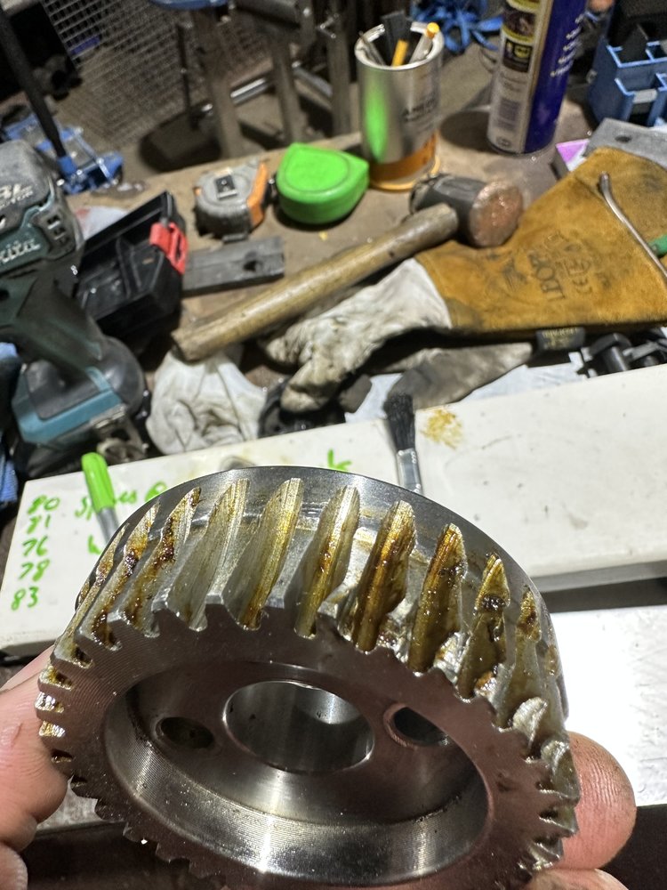

Short story. The work drive sheared. Had it all to bits and need a stack of new parts. Very annoying.
Had to cut out the work drive and drill out the grub screw. A right mess.
Have spoken to warco 4 months they reckon to get bits
As this is a Bridgeport copy, anyone aware any machines being broken for spares that may make a good donor?
