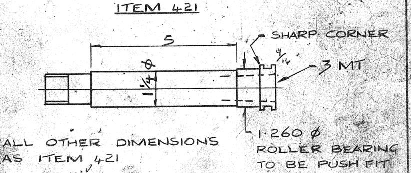

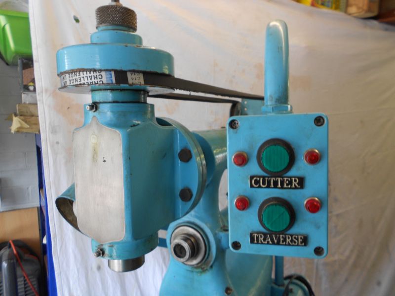

ive also got a r8 arbour via this
@MattH for collecting this for me at the time

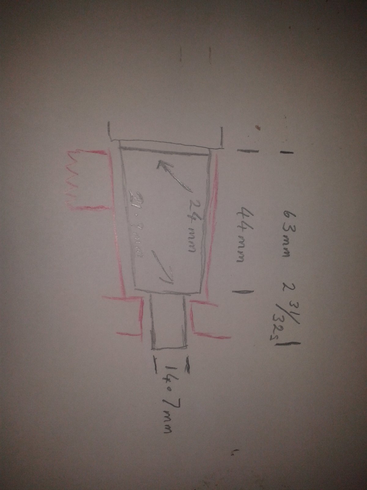

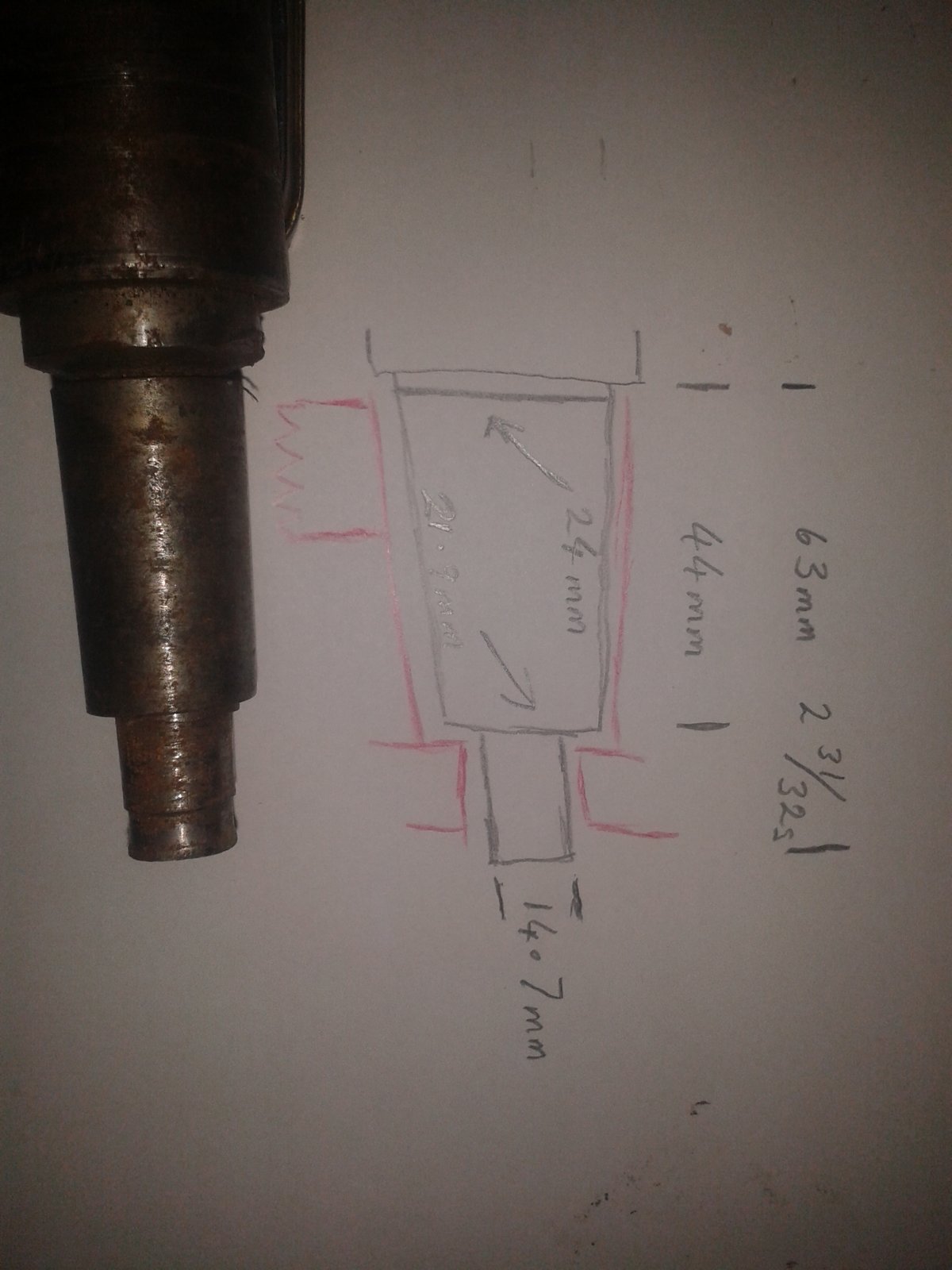

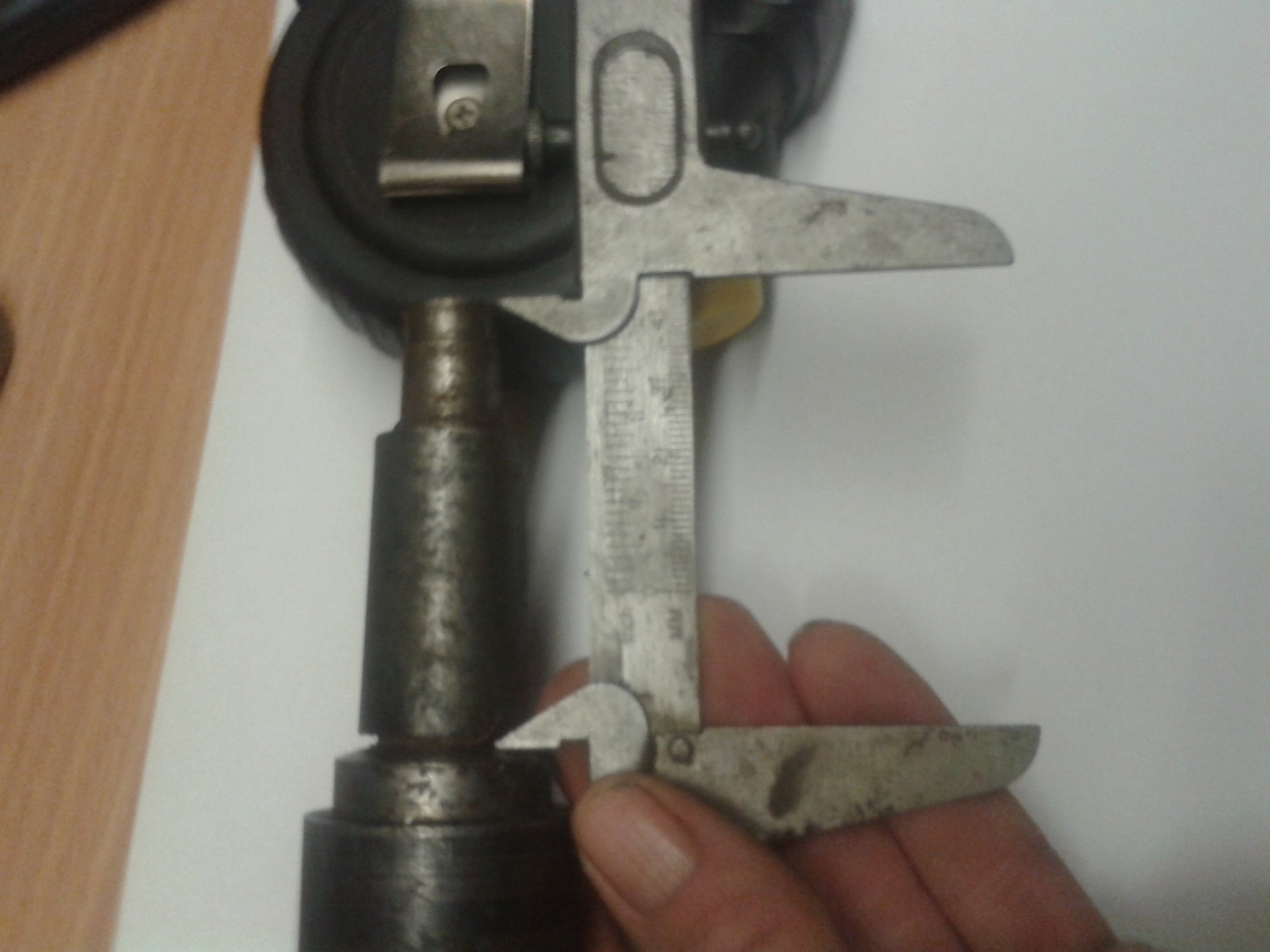

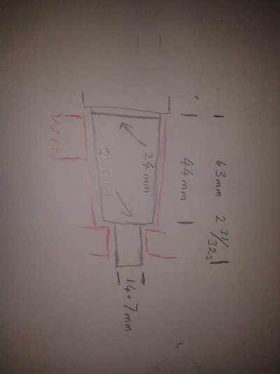

and would need a bar welded onto it so i could fit it with a belt or make a geared thing like with the dore westbury machines
i expect these parts are inside of it

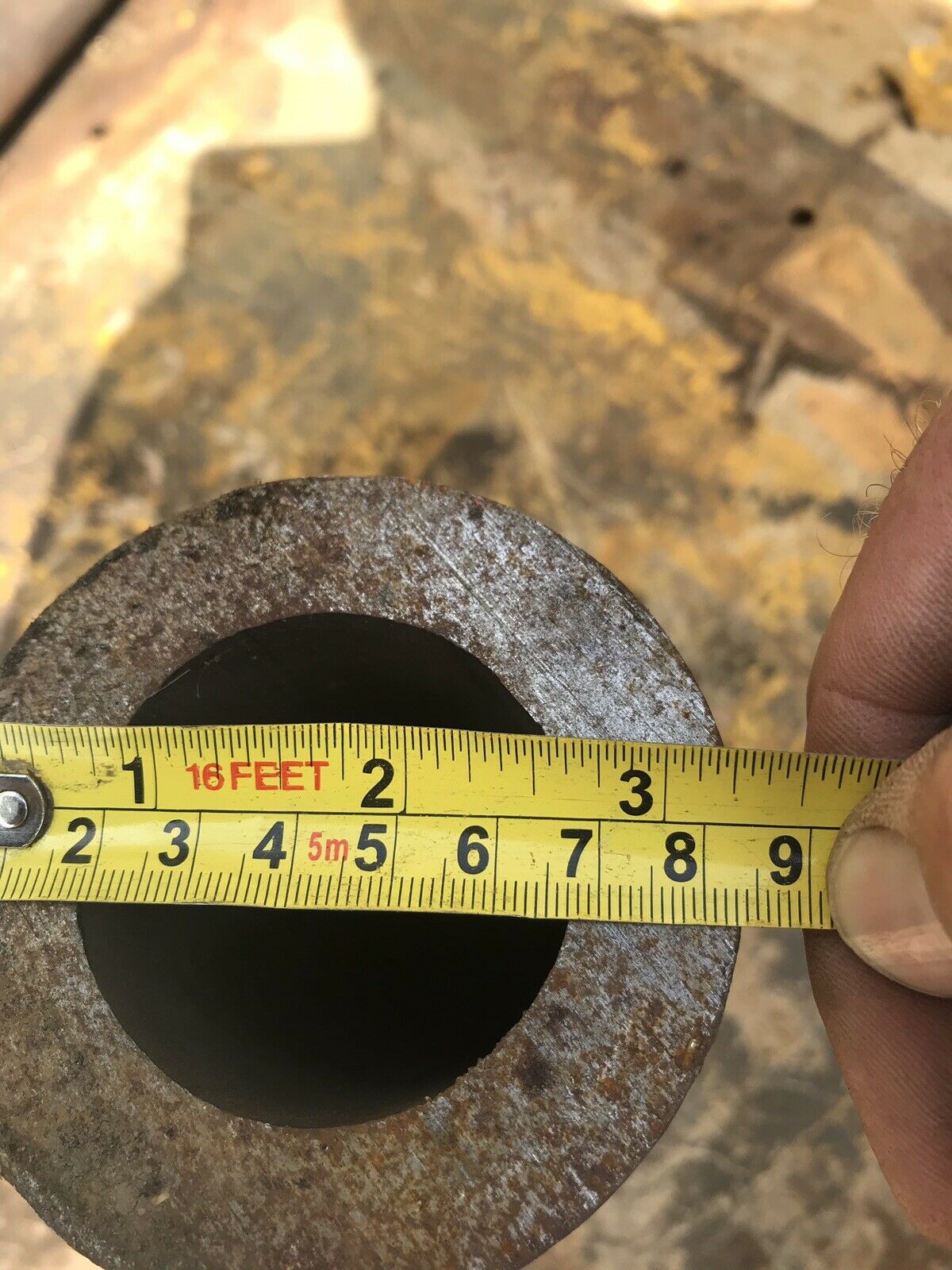

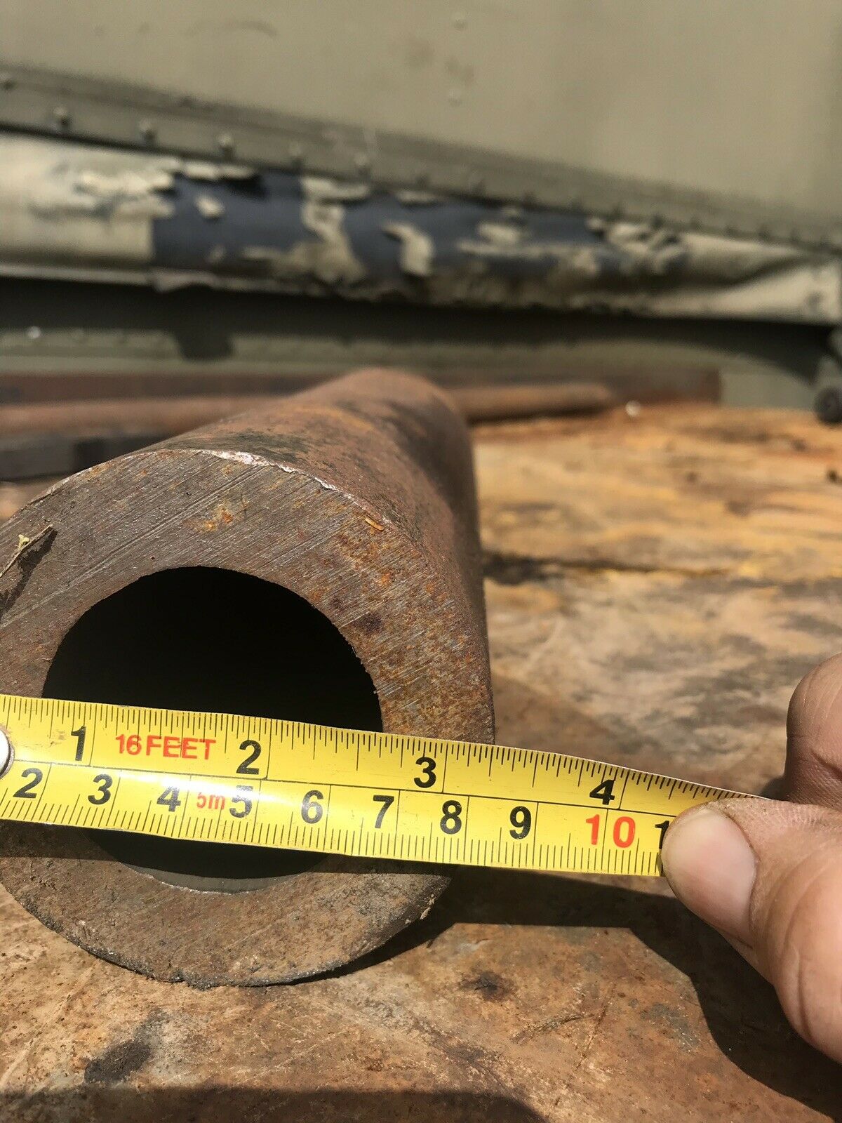

I know the bar isnt much bigger than a 3" but would need to be measured i dont want to put something thats going to put the old machine in danger of bending that arm
so im not sure whats best for it as a milling head
fizzy was kind enough to provide the quill size for the bridgeport
Approx size is 85.65mm or 3.37"
as i was going to just buy the quill but realized it was a little long on its length so wasnt suitable for my use
any advice guys would be best appreciated
