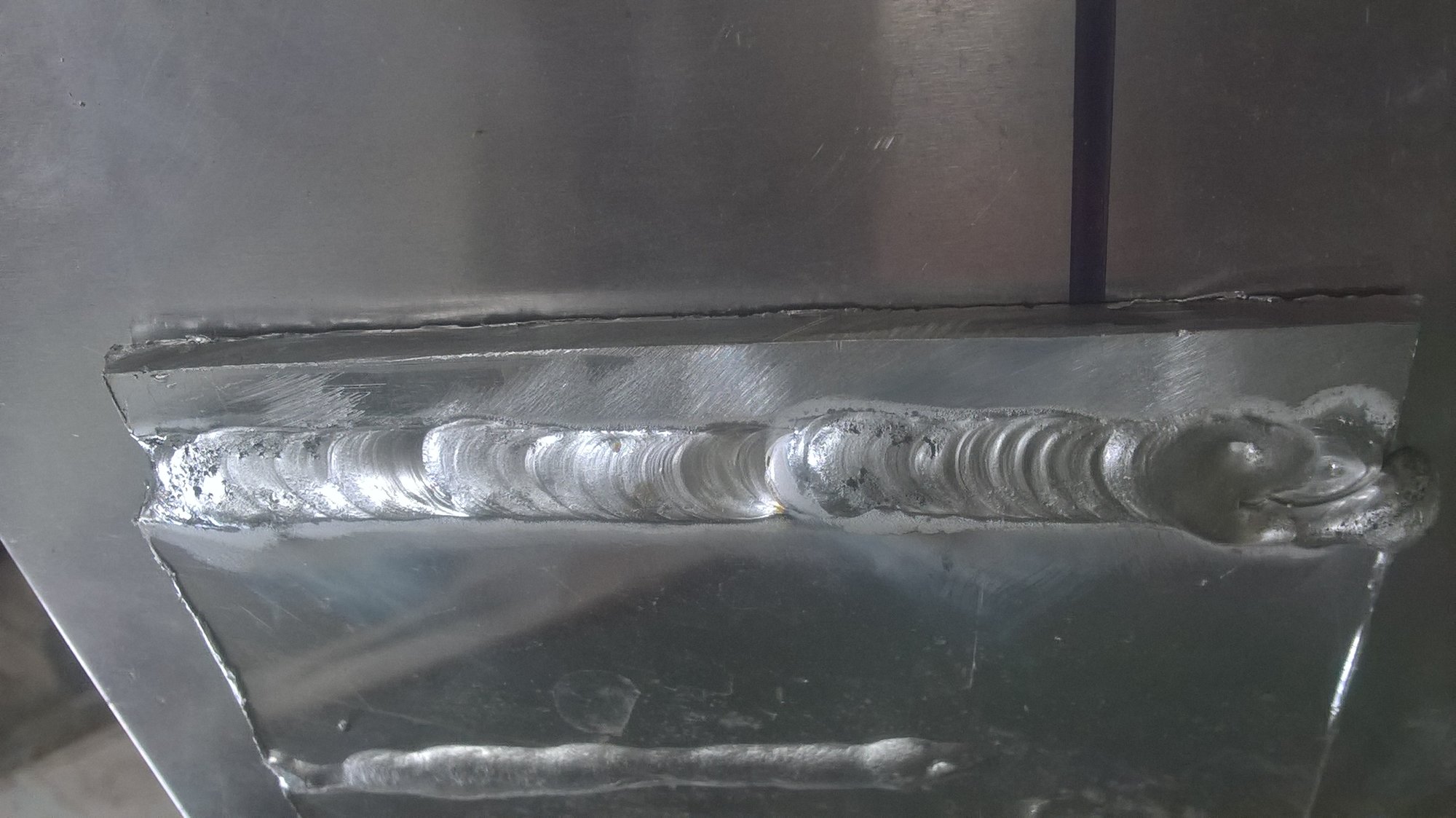

messing about today thought why not try ally never done it cut some scrap up i found down my scrap yard no clue what it is except its ally could be 6082 but meh. This is my first bead lap joint 3 mm 120 amps straight ac current not got ac dc capability 2.4 filler rod should of probably been in the 160 amp range but its of a Lincoln ranger 9 probably should invest in a ss wire brush frequencies at 70
but hey it is what it is probably could do better with a inverter but I'm not shelling out for one just to practice its got a few issues but its down to my cleaning i think. Hope you all enjoy the Saturday laugh
