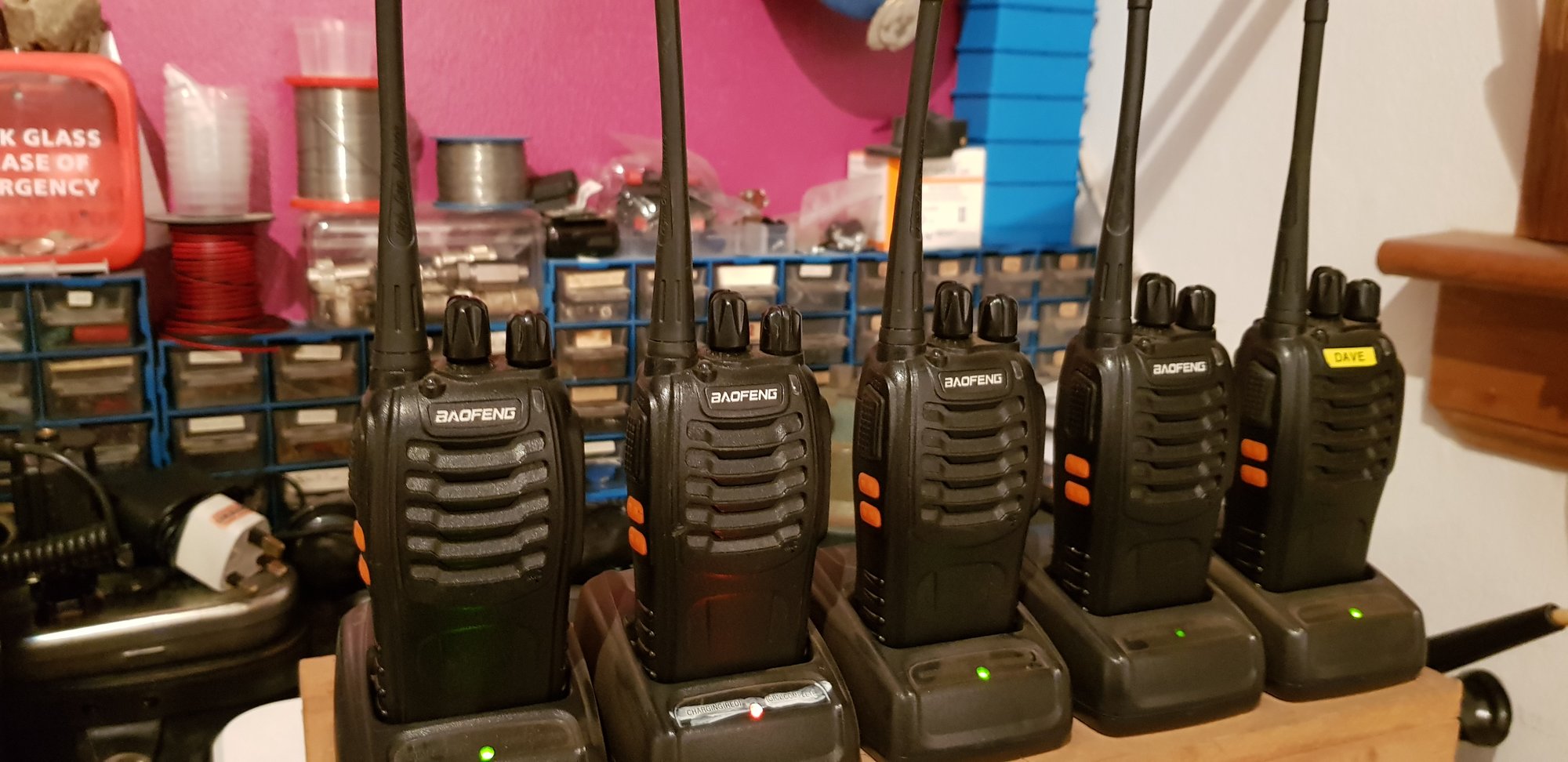

Thanks I just assumed you could programme them to the same frequency as the ones that are licence free?
Looks like its easier to borrow a pair next time I need them
The Baofengs can be put onto the 446 band, but the deviation is excessive for the channel spacing and the power output is far greater than permitted. However, the type approved radios are cheaper anyway!
