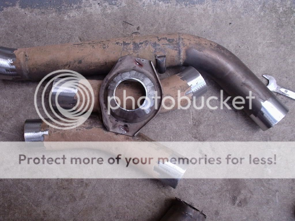

Just thought i"d put up a some pics of my hybrid side exit i made for my
Vw T4 van it cost me nowt to make due to getting 2 damaged new generation impreza rally exhausts from a place that strip the cars when brand new & prep them for rallying,the exhaust i got were noin brand new inc free forest mud
the standard flange which is very restricted
flange cut/prepped ready for tacking
all the bends that will make up my new side exit,2.5" diameter
the front pipe flange welded & linished back for a smooth flow
the finished down pipe,this as given the motor a real growl & a lot more bottom/mid range grunt + you can hear the spool up of the turbo,,its almost like a wolf whistle lol
i will put a pictute up later of the full side on view,,hope you like
ps ive lost a good 20kg in weight compared to the standard full system with fitting the side exit
