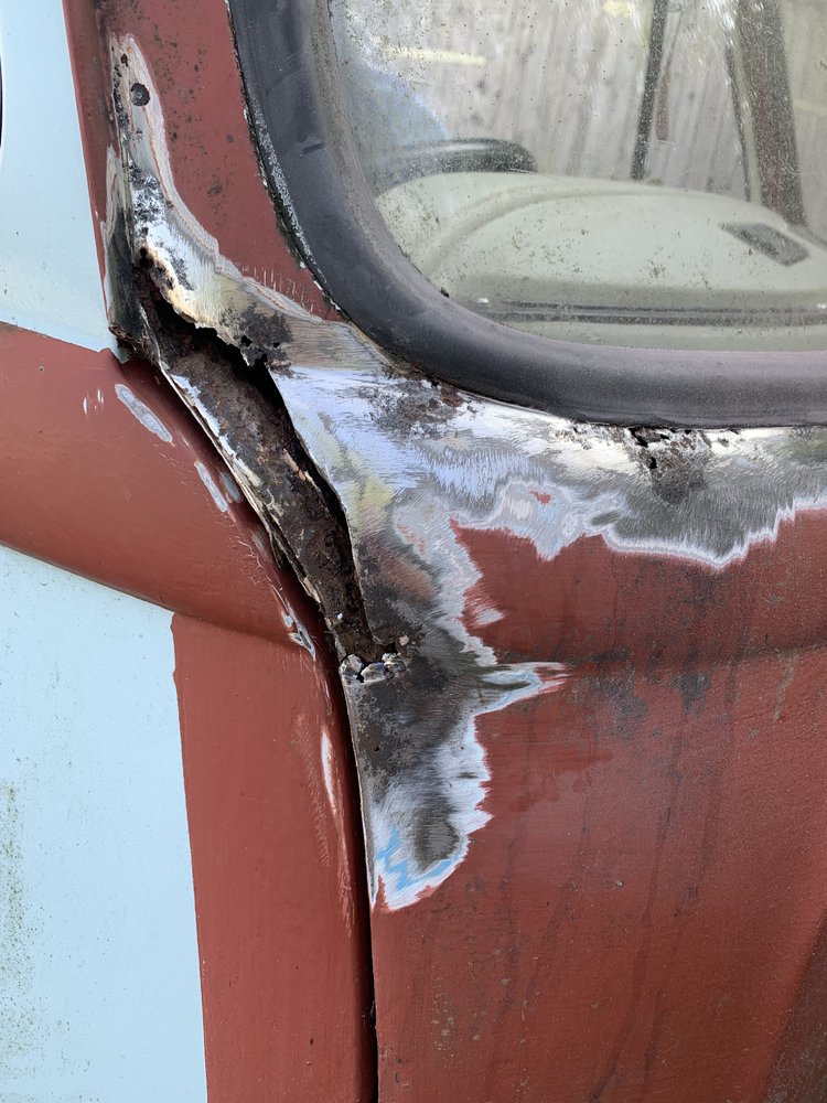

I should know not to touch rust bubbles…

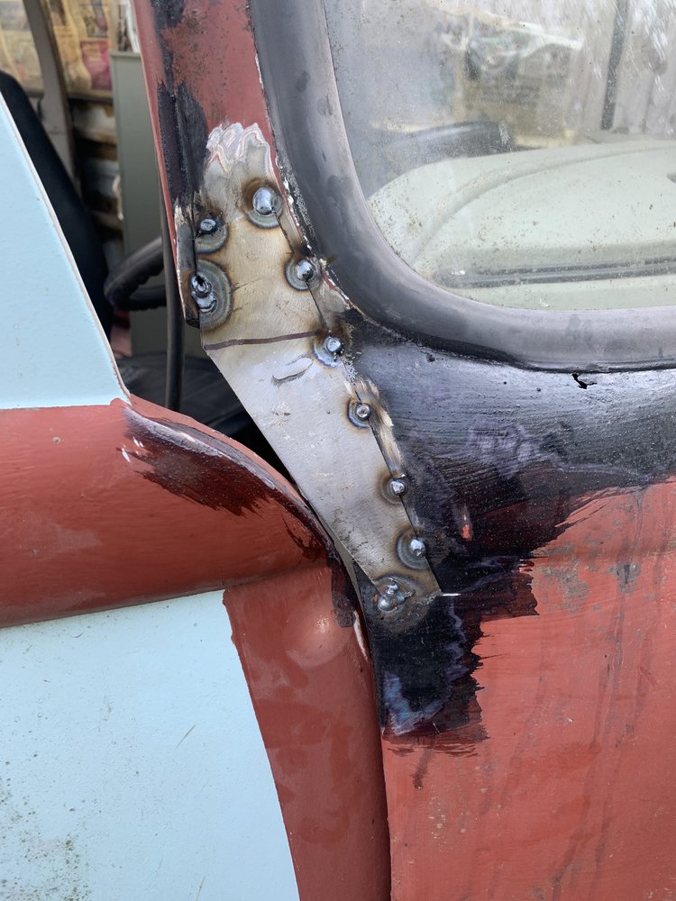

Tacked

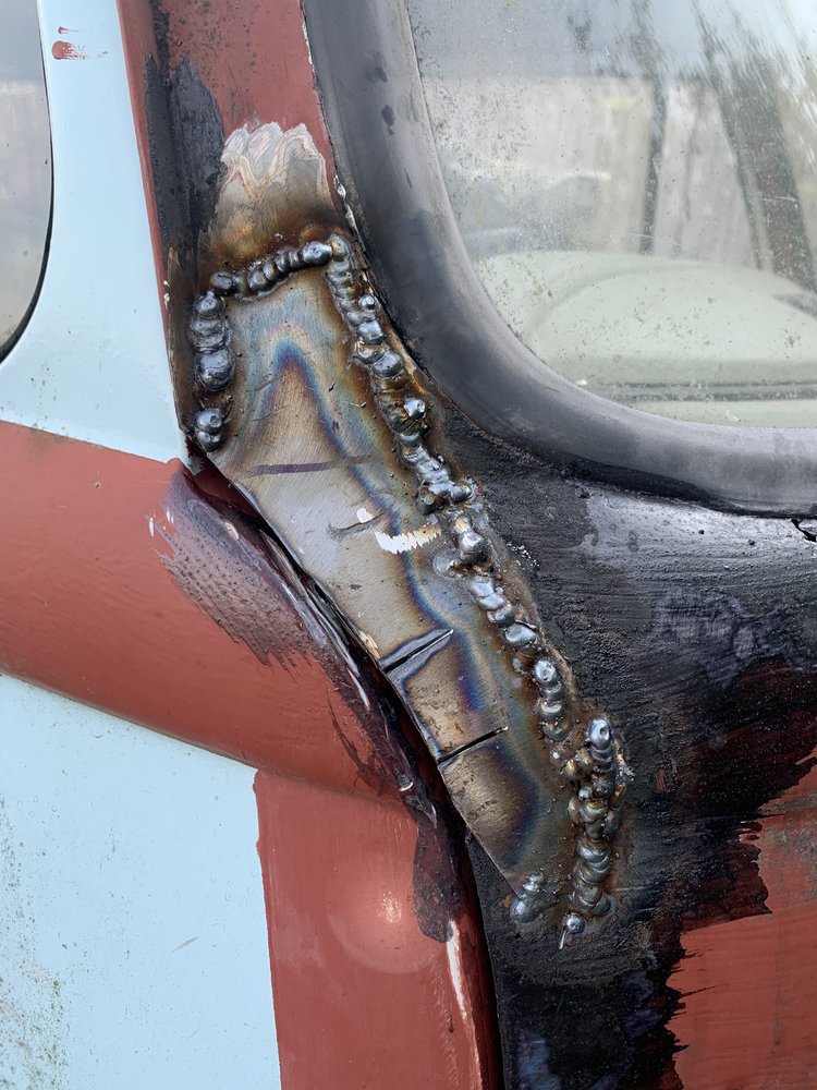

Three sides welded and slots cut to aid curving to shape.

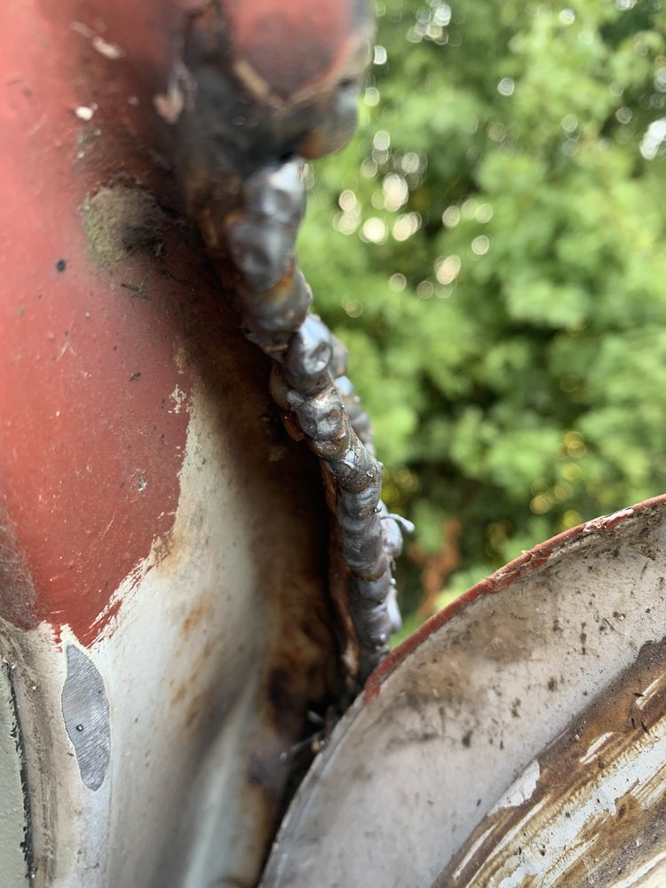

Inside edge welded.

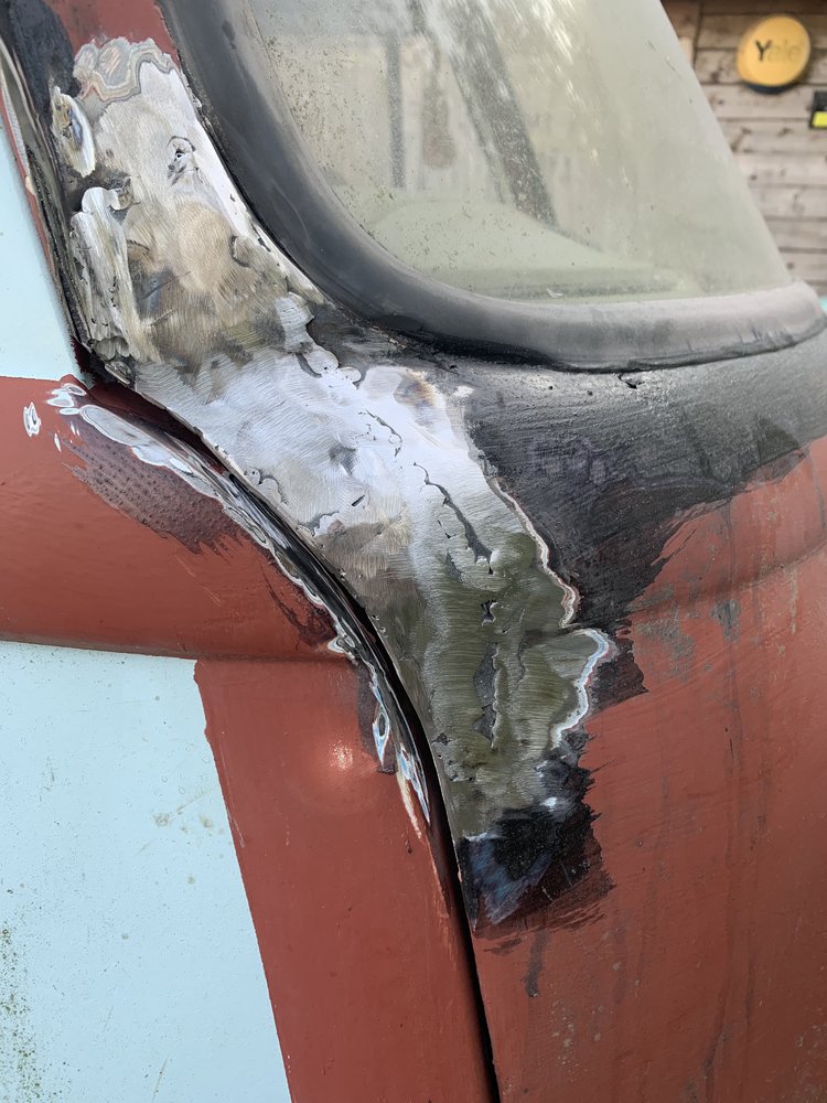

Ground off. A small amount of filler needed but hopefully not too much and it’ll last another 50 years!
