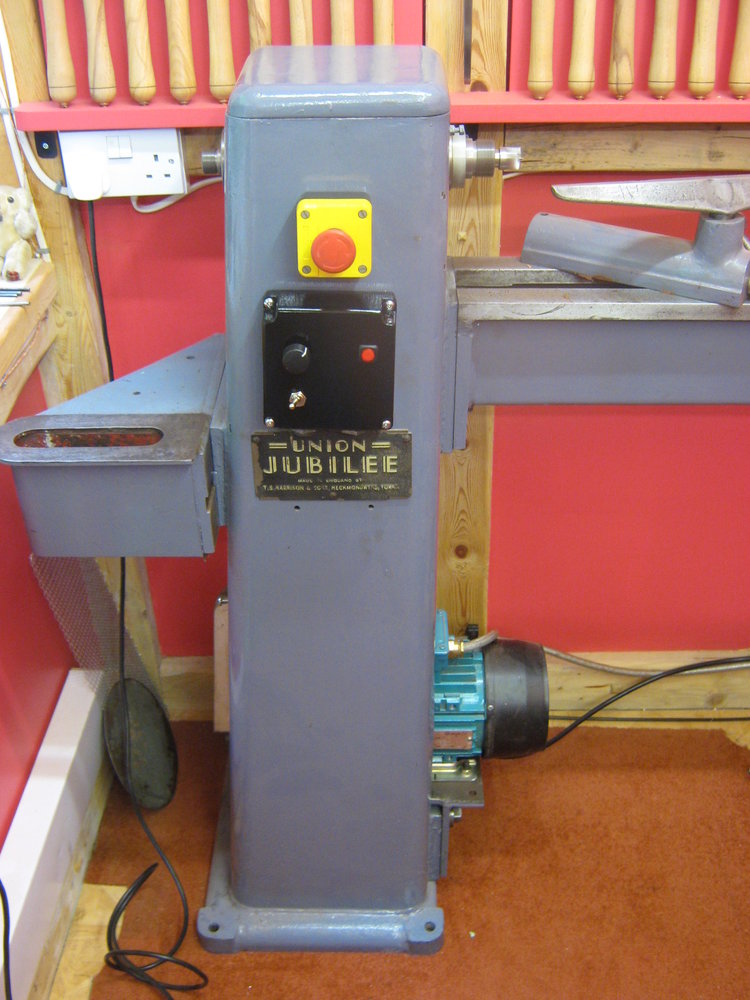

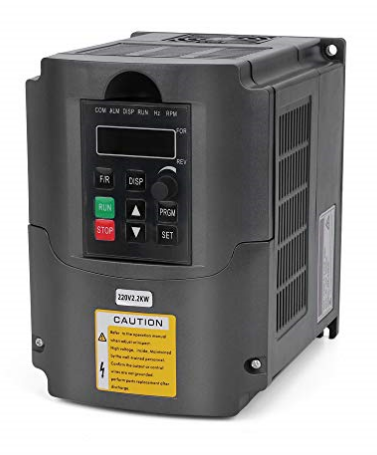

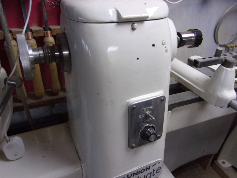

Hi all found huang inverter , can they be fitted with a pendant type control box for start stop , fwd reverse, speed pot , and jog,

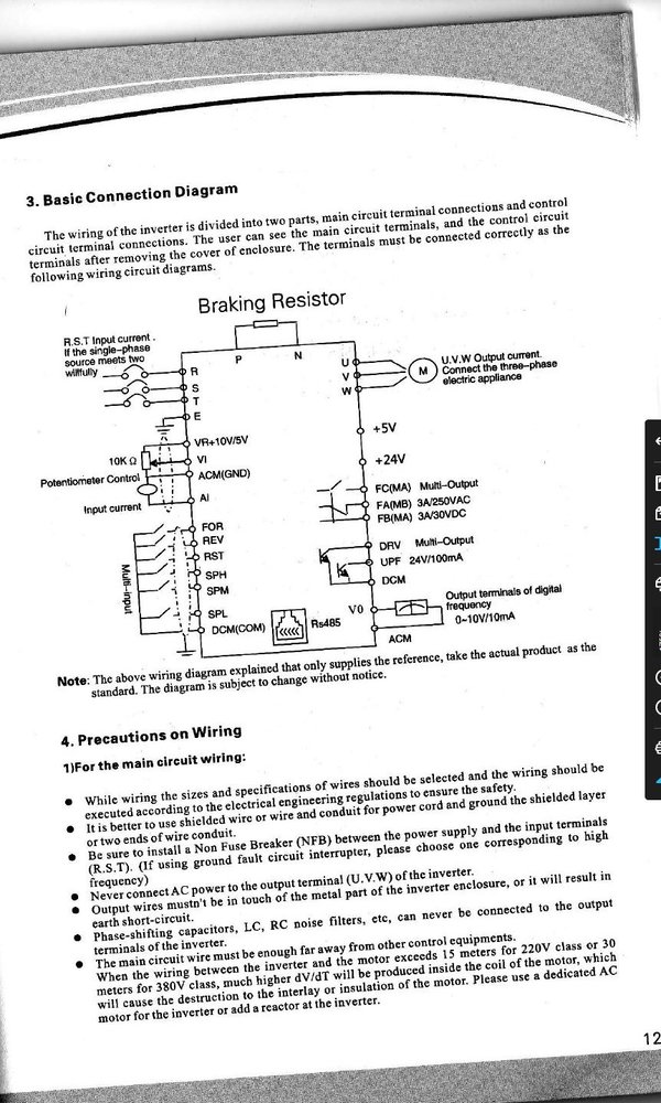

If I had a link to the manual for huang inverters I wouldn't be asking, however in previous replies to my initial post others have fitted these inverters
One last question , I assume the multi input switches are momentary action ,
