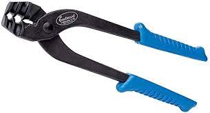

No - but the bender allows tighter, smoother, neater bends if that's what you want or need.you dont need anything fancy with that size of tube
ive spent years bending and straightening that stuff by hand
you can bend it easily with just your thumb and hand while the other supports the other side and just gradual movement will round it off nice for you
I have a straightener that my mate 3d printed. The pipes need to look great.Ive a pair of bending pliers Ive had for ages ,, sykes pickavant , they are hardy and all the bends look neat and tidy , nothing worse looking than a new chassis with brake pipes on it that look like a farmer bent them over his knee , trick is to get the pipe straight before starting to bend it, or so I find
same as those and very cheap and handy.
2 pieces of wood screwed together and drill its free and does the same thingThey aren’t cheap but the Kwix pipe straighteners are awesome. Nothing looks worse that a long run of pipe that someone has half heartedly straighten by hand. They are arrow straight after running them through the Kwix. I know they are £40+ But worth every penny.
