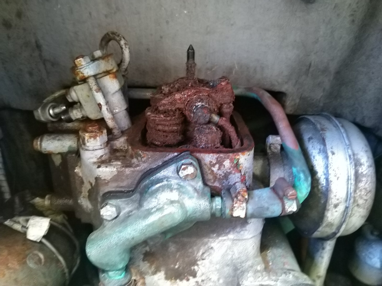

This is off our small sailing boat (the big one has RR engines!) it's a late 60's Volvo MD1 puts out a whopping 5hp and weighs as much as the keel. Never worked when we bought the boat and the previous owners had installed a outboard on a drop plate on the transom, - which is horrible to use. Boat is due back in the water next week so left it to the last minute but thought I would take the lid off an have a look.
Hmm a bit of rust on the rockers, and a broken spring - which I assume was why it was abandoned.
Valve is jammed open but the bore looks OK. the top ring is stuck hard.

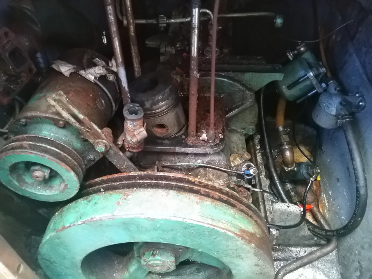

There is oil in it but will not turn over by hand even with the barrel off, I suspect it was left in gear to stop the prop rotating and that has seized. Next job to disconnect the cable and hammer the gear lever!
Top end parts will get chucked in the electrolysis/citric acid bath, if they look salvageable and I can find a valve spring then it might be saved.
