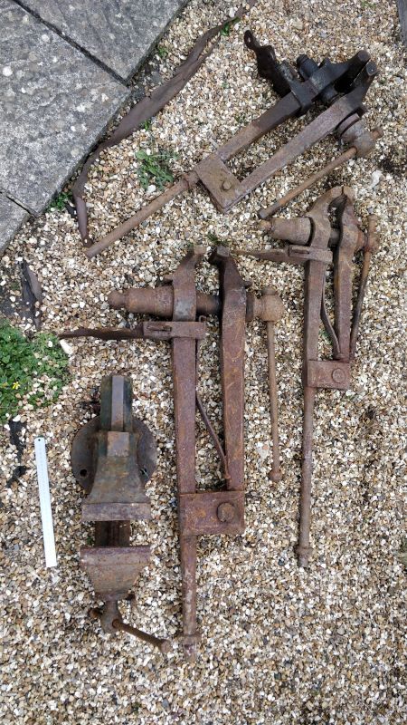

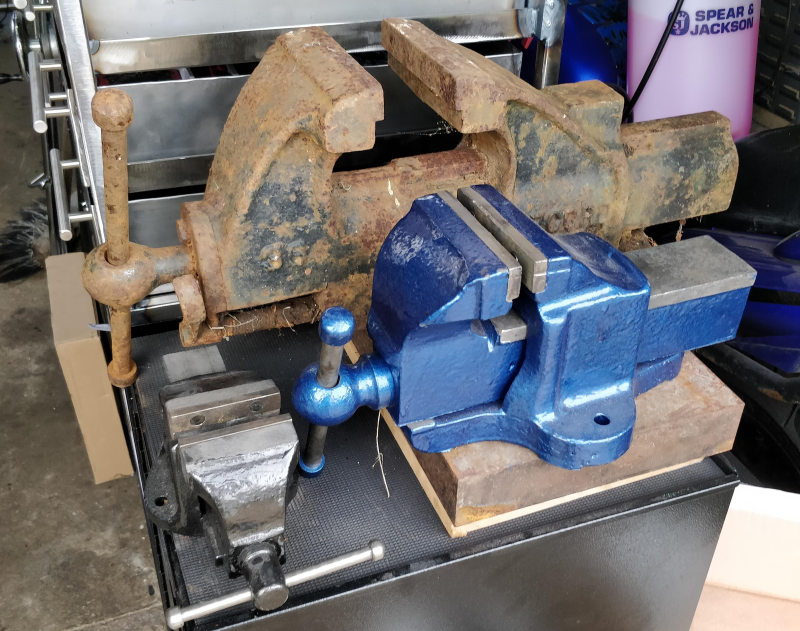

A week or so I ago I put a post on the long-running "Today I Acquired" thread about some vices I got out of a skip (with permission, I hasten to add). I thought I'd create a thread where I can add photos as I gradually get them back into working condition.
These are the vices - three leg vices and a big bench vice:
Here's another view of the big bench vice that gives an idea of its size:

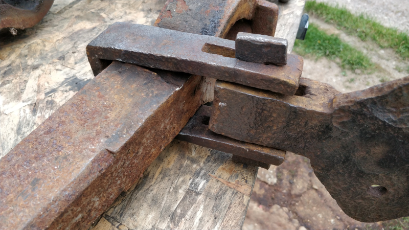

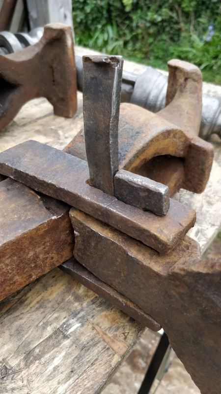

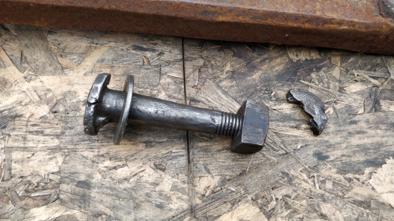

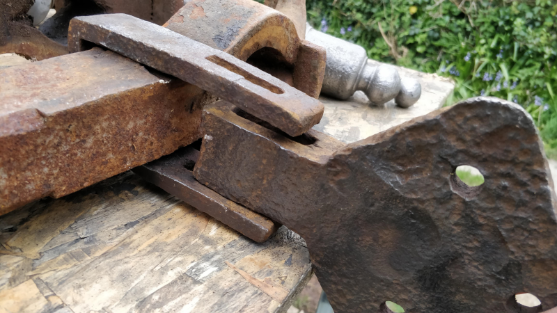

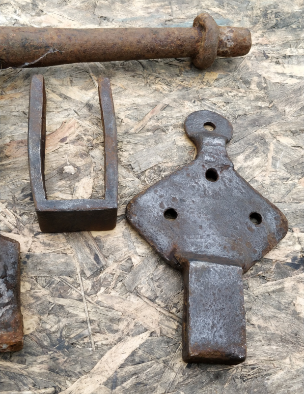

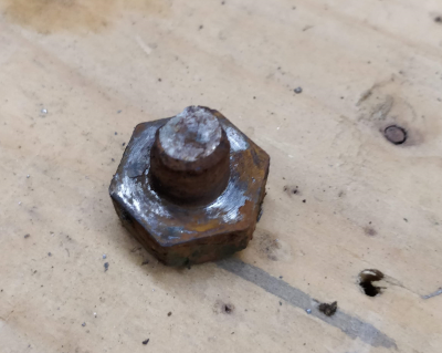

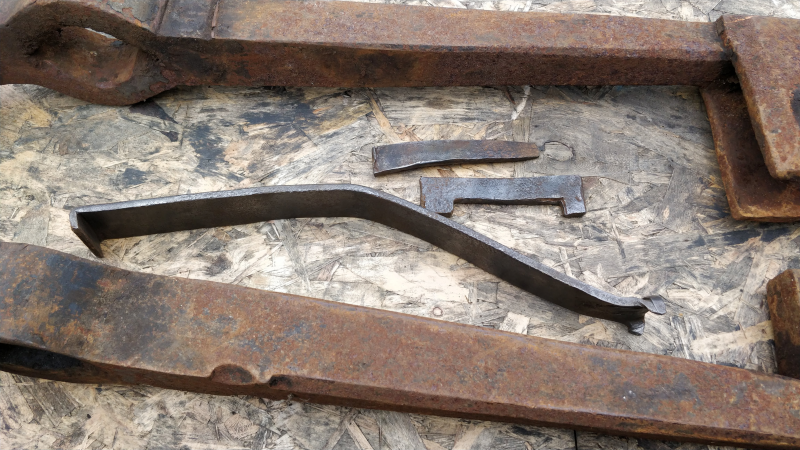

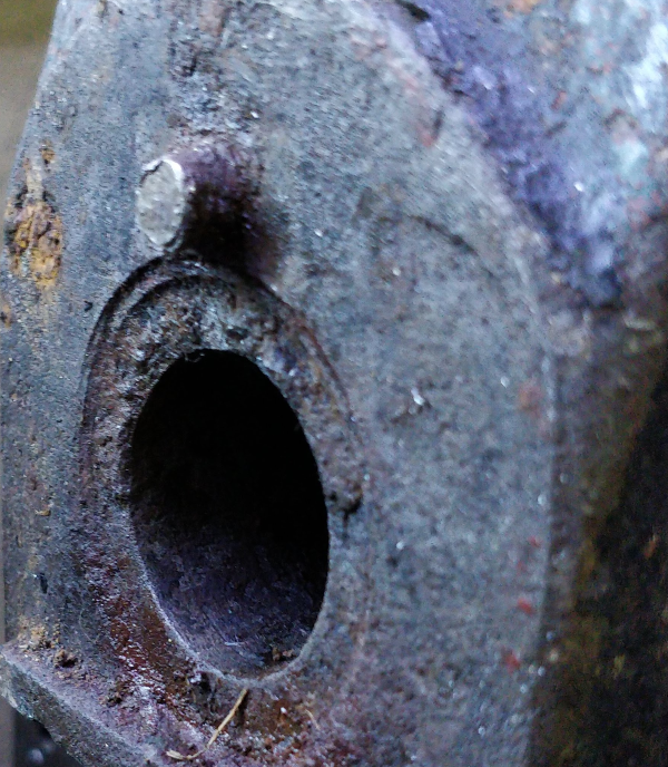

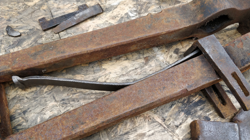

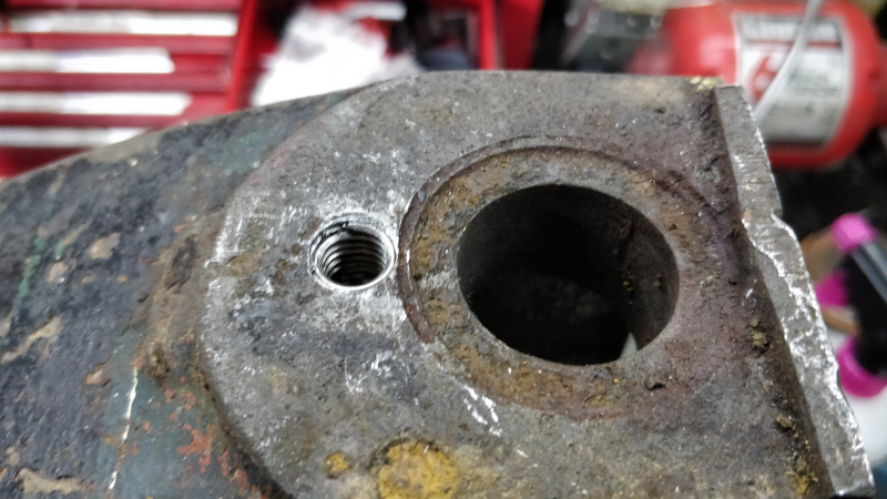

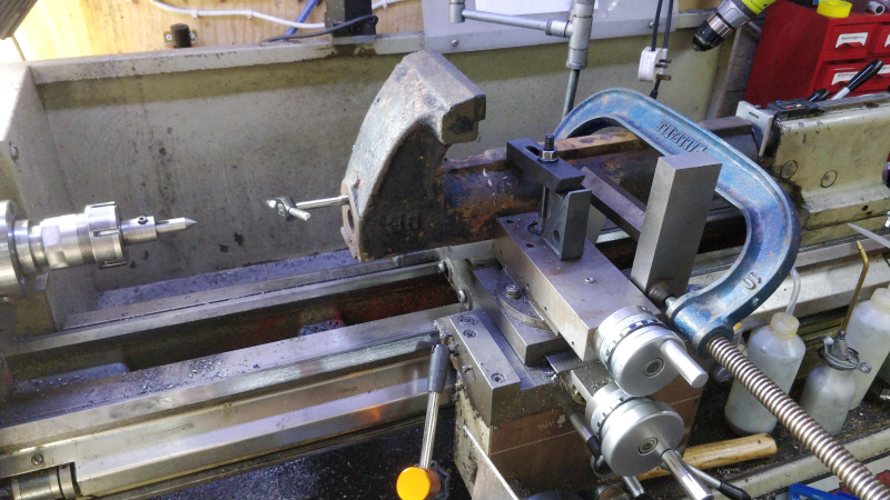

The quick release mechanism on the vice was completely jammed, as were the two jaws. When I tried to undo the hex head bolt that you can just about see on the left of the vice in the bottom picture, the head snapped off with very little torque.
Having the head snapped off, it was at least easy to remove the plate that was held on by the bolt.

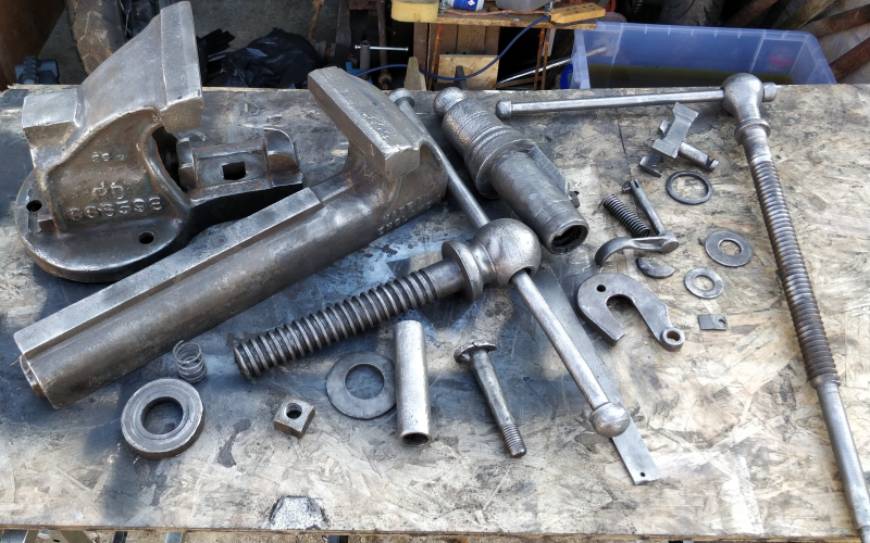

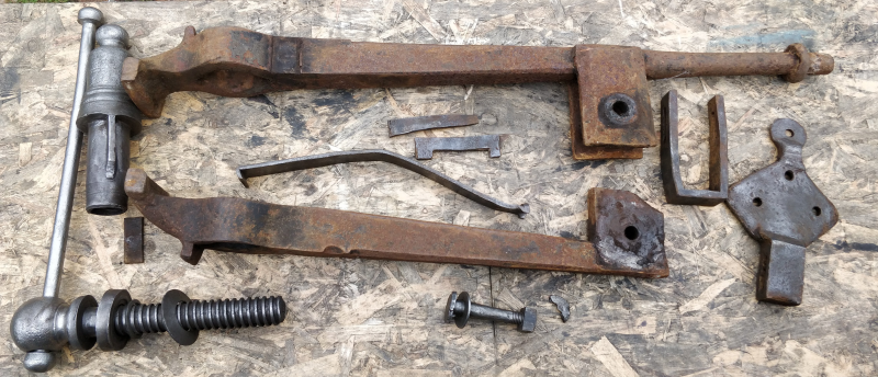

There's some details in another thread about the efforts to get the two jaw castings apart, suffice to say I did manage to do so in the end.
