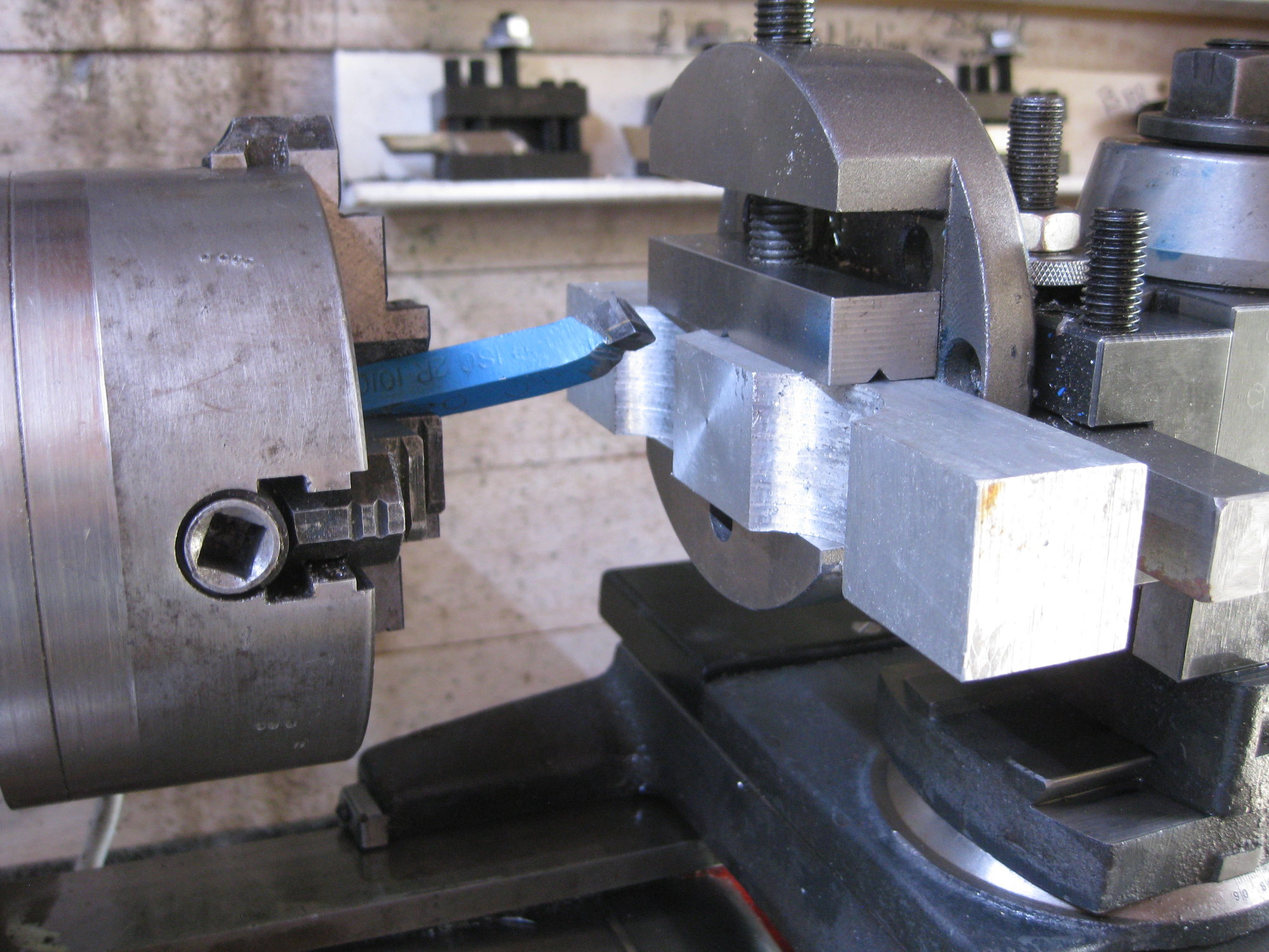

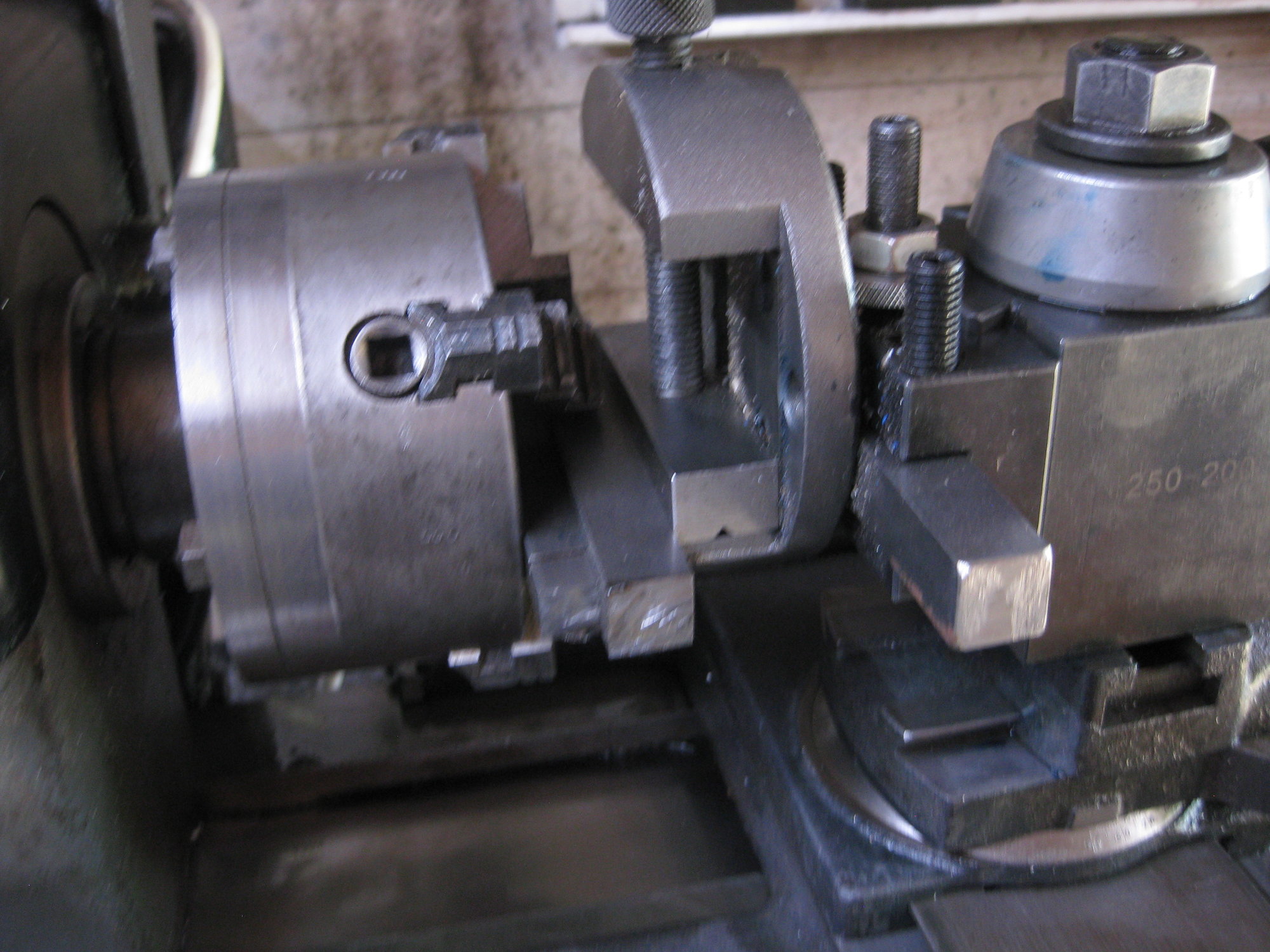

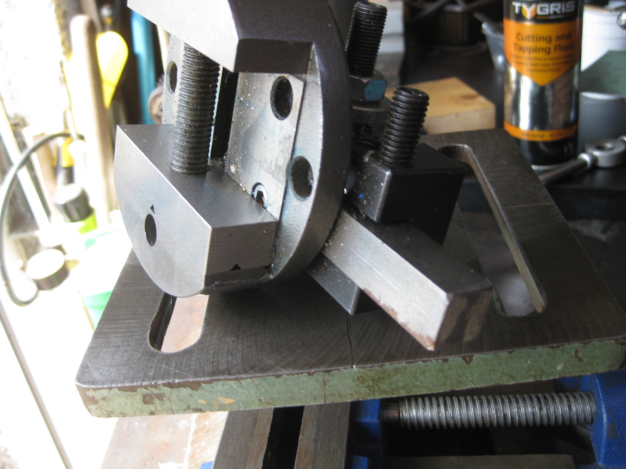

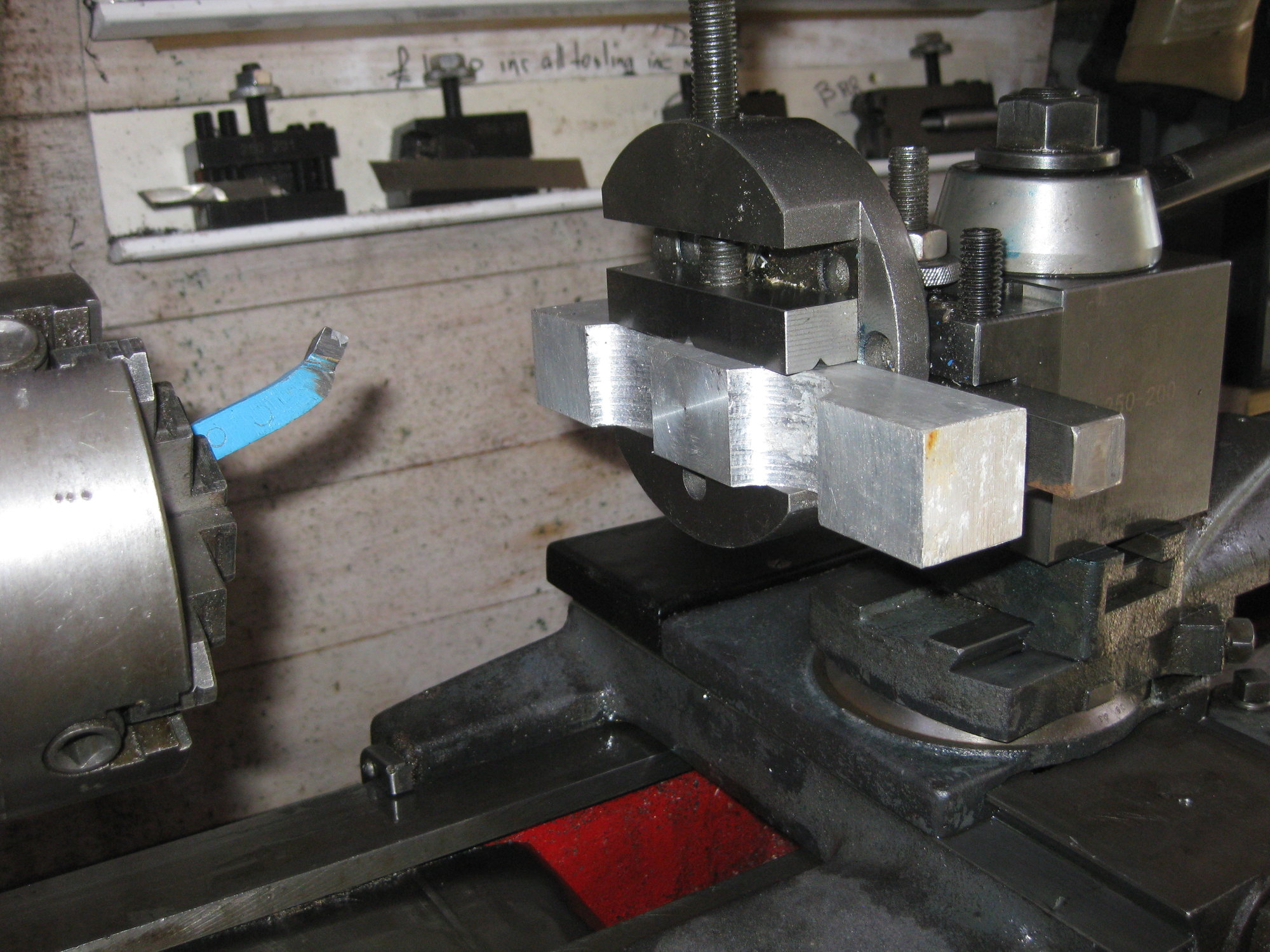

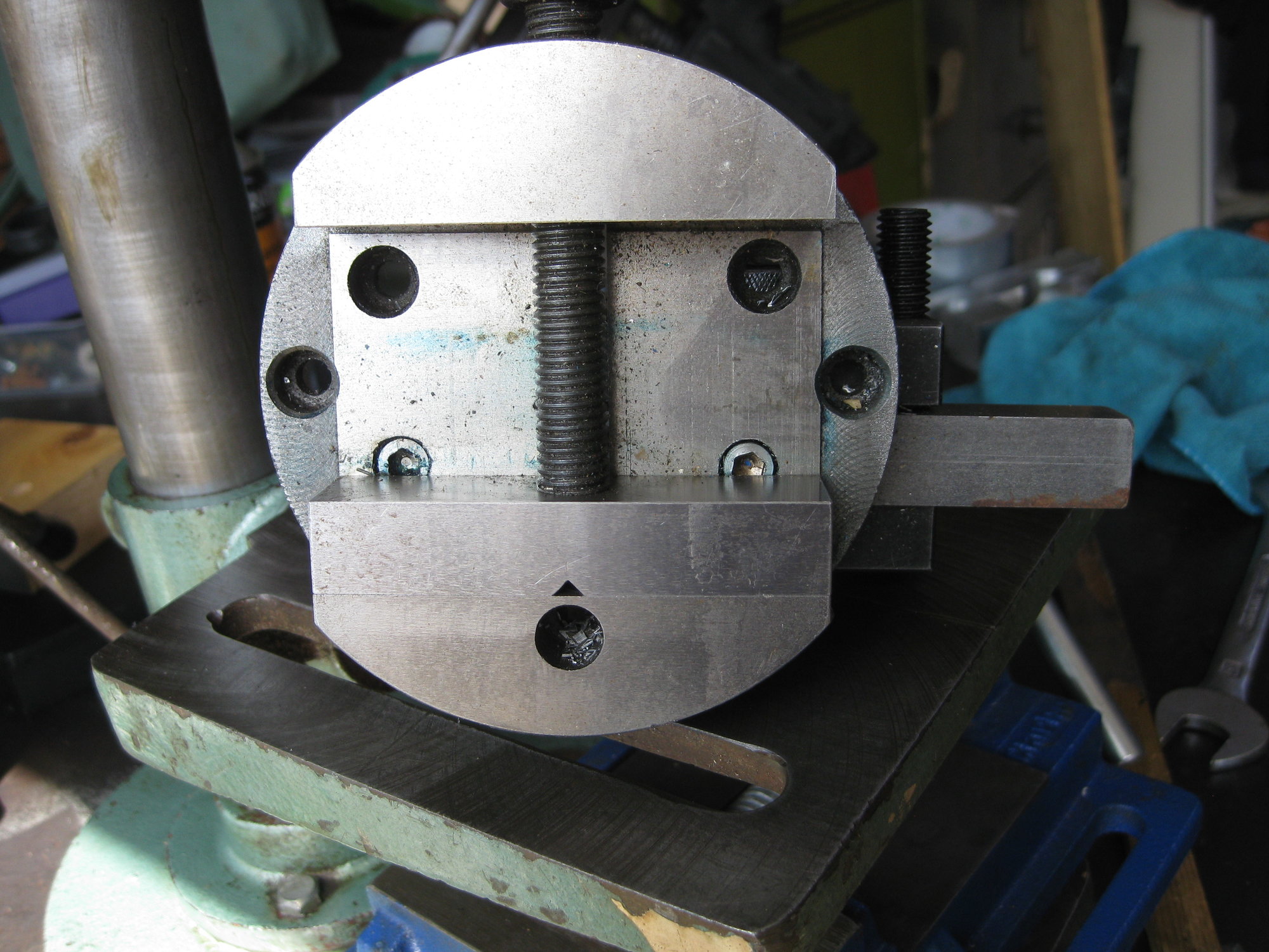

As promised a few pictures of how I made a small vertical milling set up for the Sphere lathe . Had a job thinking how I could ensure it was mounted parallel to the ways . When I realised I had numerous bars of precision ground key steel , made up a platform on each way , put a bar of key steel in the jaws once I put in one mounting screw , used 1.5 thou feeler to level it to the other mounting area , having put a bit of super glue on both mating faces . Once it was set it a few hours later was easy to drill the remaining mounting hole .
