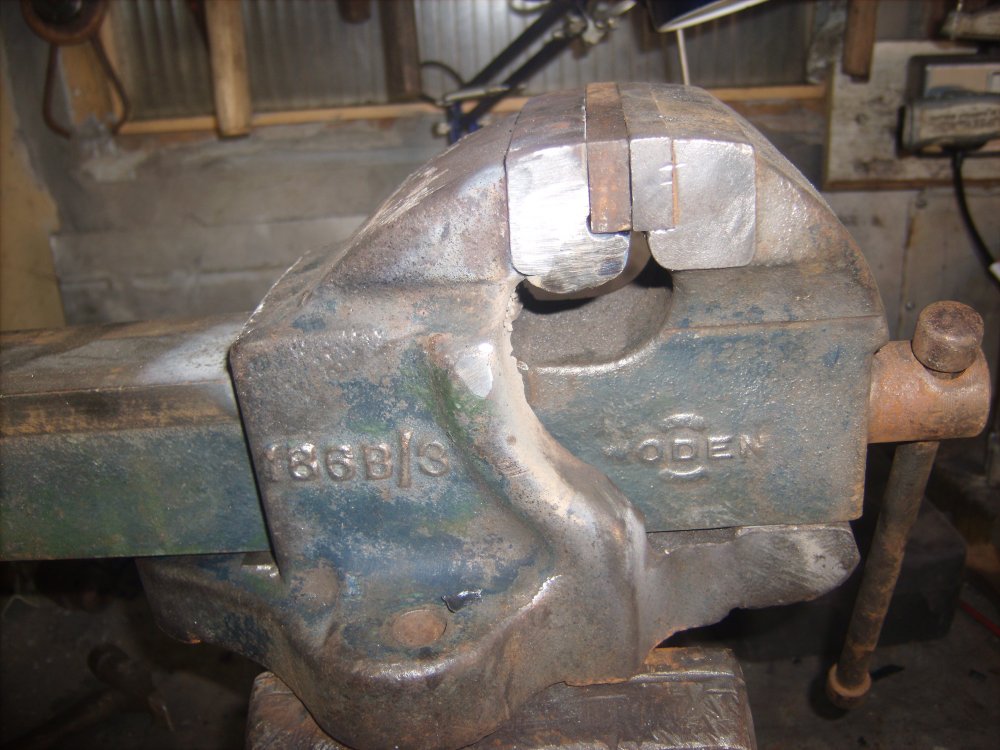

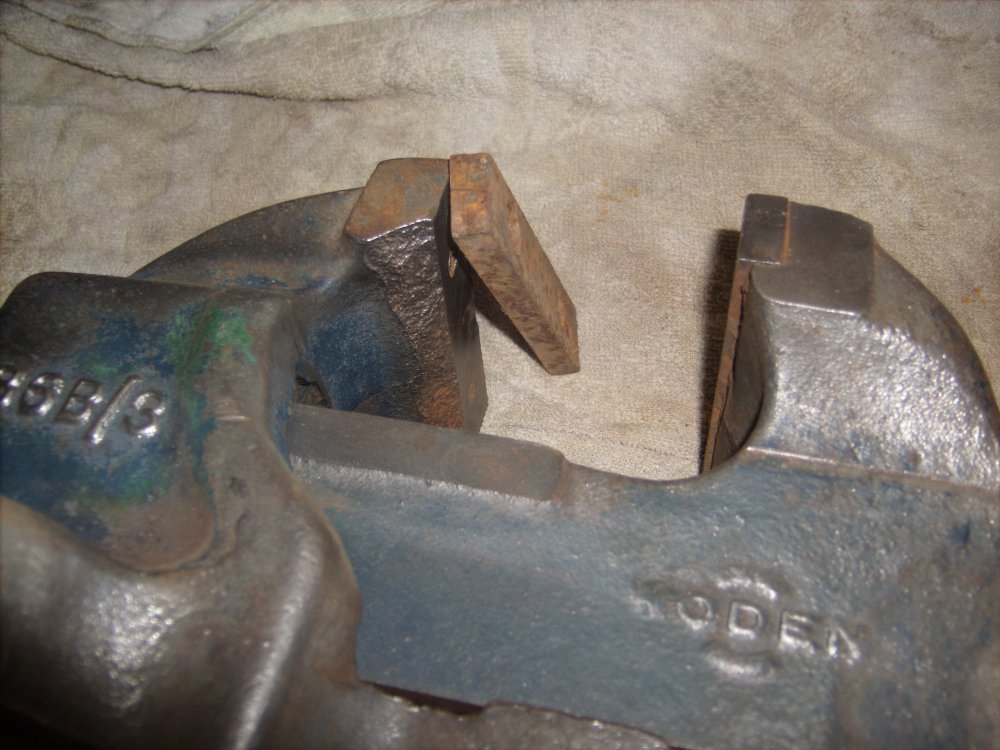

Hi all, while since I posted on here. Anyway, bought a vice at a car boot for a £5er. I did'nt realise anything was wrong with it, I thought it was just seized closed and would be more like a penetrating oil job. Got it home and a smack with a hammer soon loosened the screw, then the one jaw fell out. Seems this vice has had a rough time some day and someone has broken the step off that holds the jaw in place. My repair thought is to drill and tap, screw a row of high tensile steel (probably 6mm) bolts in to form a new step, grind to level and shape. Wondering if someone here has any better idea for repairing? I don't really feel like going to the trouble of preheating and welding.
