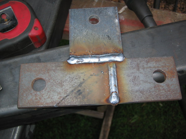

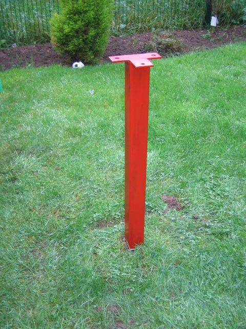

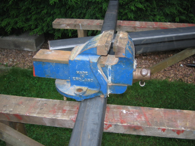

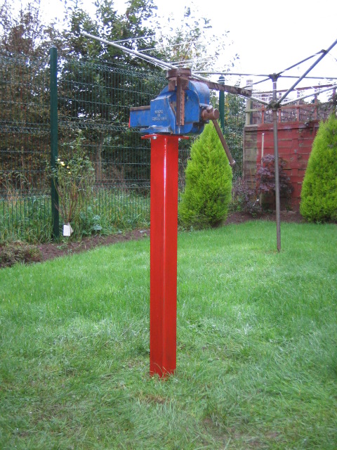

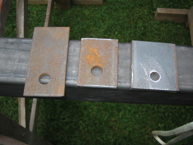

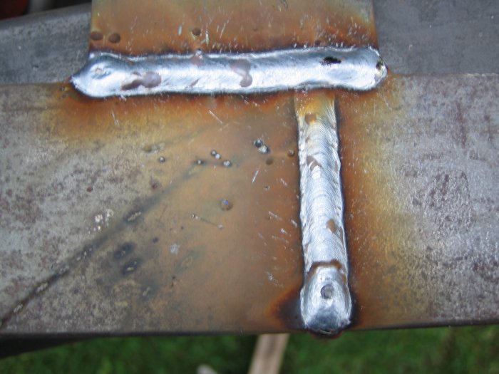

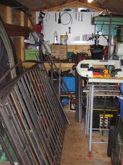

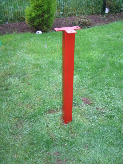

I had no where to put my vice in the the shed so I decided to put it outside, I put a sleeve(75x75x2 box) into the ground for my post(70x70x2.5) to slide into so its removeable and can be put in the shed when not in use
As you can see no where to swing a cat
The Vice & Post
Mounting Plates
Welded together
Painted Red oxide
You can just see the sleeve at the bottom of the post
Vice Attached
With the scroll former attatched it's real easy to pull them around without hitting the walls of the shed
