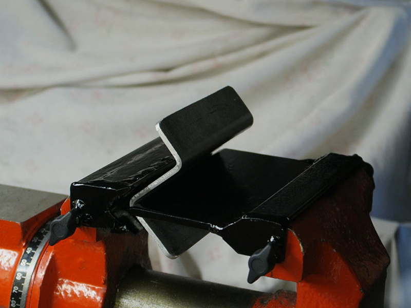

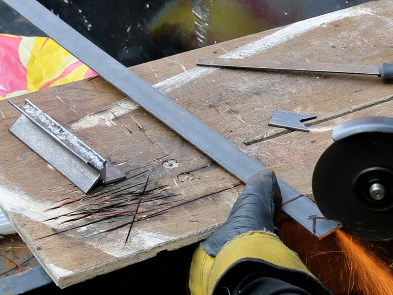

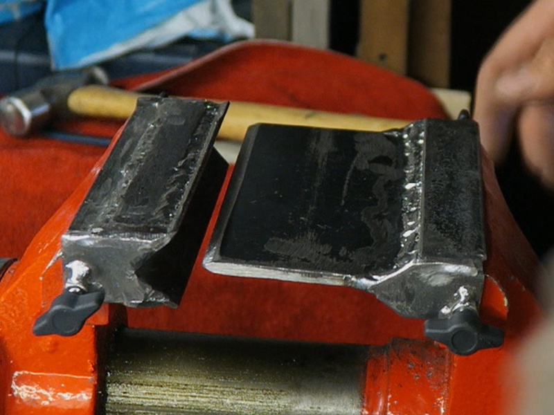

This is my homemade vice mounted metal break which bends 5mm aluminium plate with ease it is also good for steel and other metals great for various Fabrication jobs I keep giving myself
Bends 5mm aluminium with ease

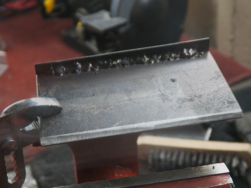

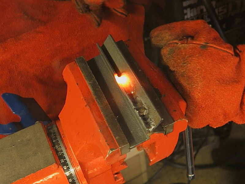

Welding the female jaw
Cutting the sides

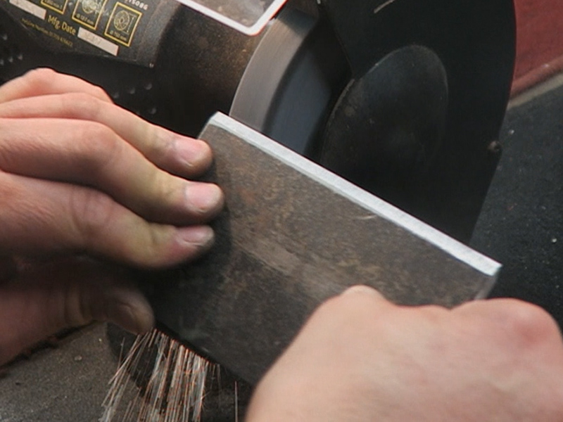

Grinding the male jaw

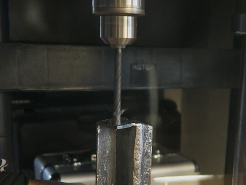

Drilling holes for the vice clamps

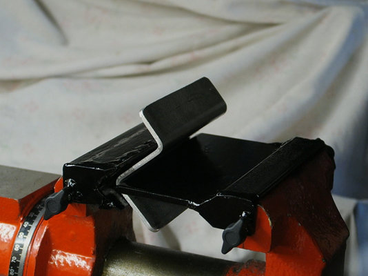

Finished press brake
