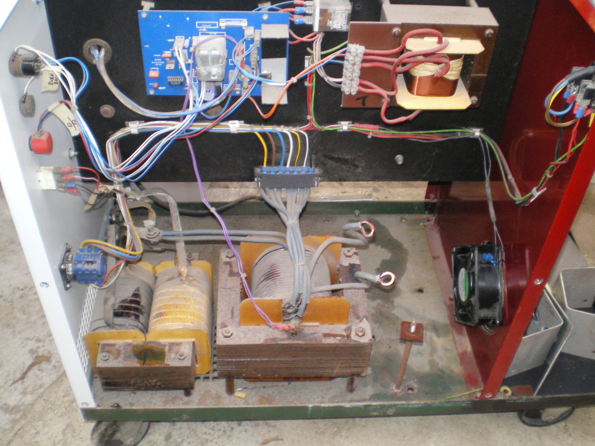

I bought this BOC Migmaster 180 the other day and wondered if anyone had access to a wiring/circuit diagram at all? I enclose some pics which may jog someones memory.
It is a non-runner mainly, I think, because one of the two massive rectifier diodes ( it's a centre tapped secondary transformer) is open circuit. The other one I'm not sure about as yet as I haven't had time to test properly. The wire feed sounds really odd too. Seems to sort of 'stutter' when running mainly noticeable at very lowspeed. Sounds a bit like a two stroke motorbike idling?? as if it's a PWM control switching at 5hz? Will look into that in time.
I only collected today so have had very little time to play- Christmas and all that. I removed both rec diodes and powered it up. I get an increasing AC voltage from the transformer with switch steps but my breaker tripped out at max setting. Not sure if that's a bad sign since it had no load at all at that point. First look at the wiring suggests it might be a simple step by step tapping selector power switch system but not sure of this yet. It would be nicer and a lot easier if I had a circuit diagram to work to.
It has been stripped and tarted up at some time with a quite nice spray job and tidy up. Just a bit of dust collection now which I'll clean up.
It has Spot timer and burnback as well as wire speed pots and three inductance choices.It's well built as you'd expect and bl...y heavy. Copper wound transformer and chunky auxi
liary supply to the electronics. Control board seems surprisingly simple at first glance with only one IC which I believe is a dual 555 type timer (I say that from a very quick glance earlier so could be a dual op-amp??) and a few disceet components. One puzzle is the pot mounted on the board just right of centre in the pic. Does anyone know what this is likely to do?
So if anyone has one of these or can point me in the right direction for info I would be grateful as I can't seem to find anything on here or elsewhere on the net about it.
