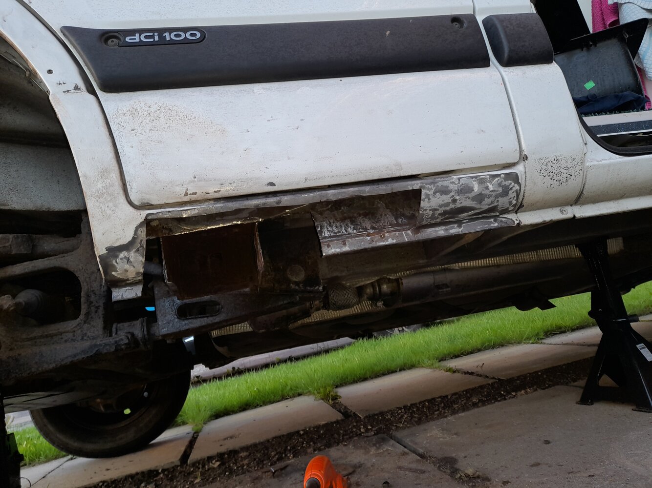

So, out in the rain this morning to start on my Camper. Bubbling under some stonechip on the n/s Sill, and a crunchy jack point had already told me some remedial work has to be done.

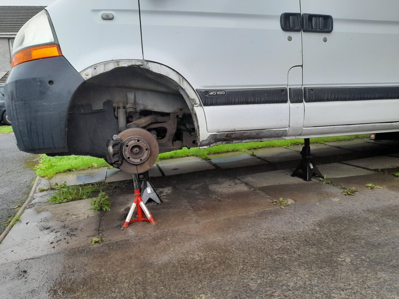

The recently bought Vevor air jack came in handy & saved lots of effort & faff to get the van raised somewhat - handy bit of kit, I like it!
Halfords 4-tonne axle stands & another folding axle stand under the front suspension arm.

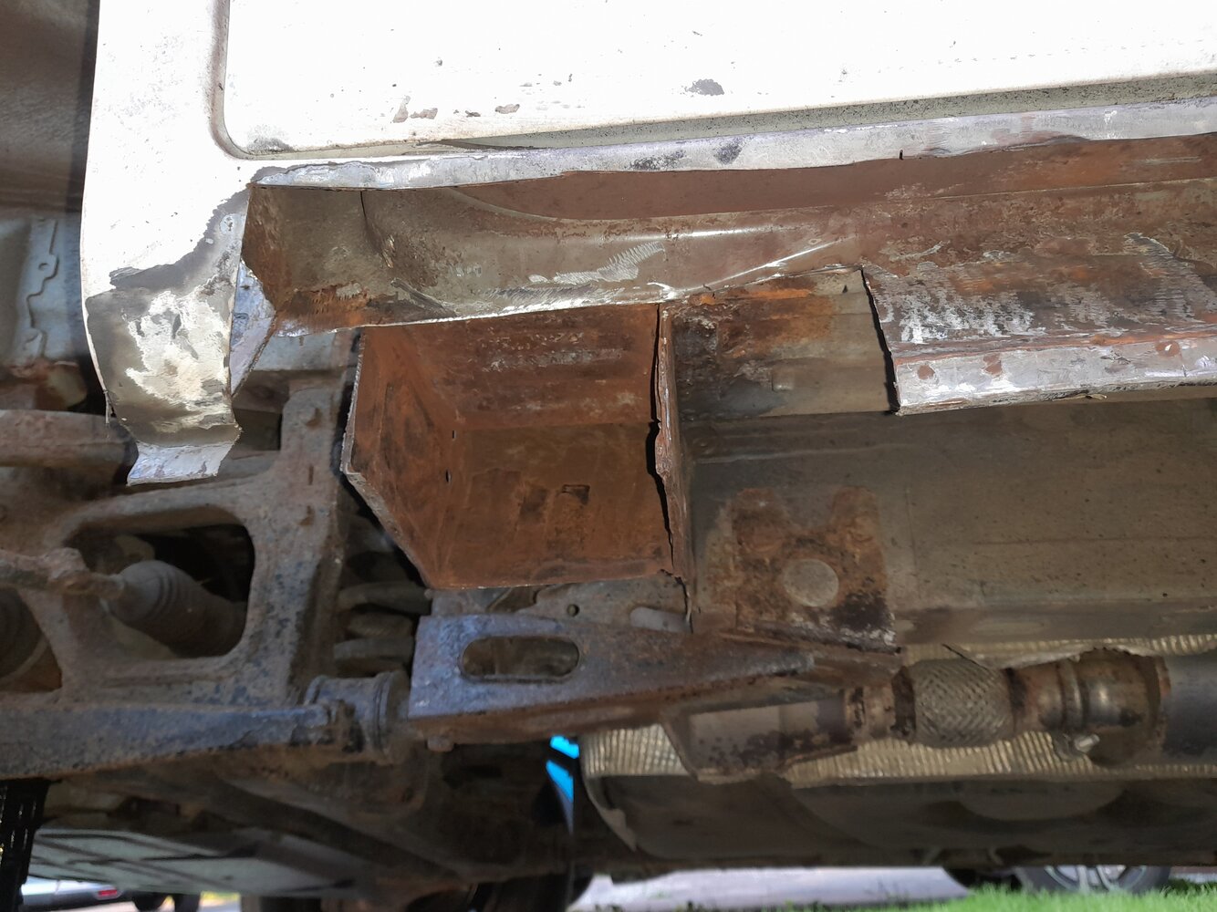

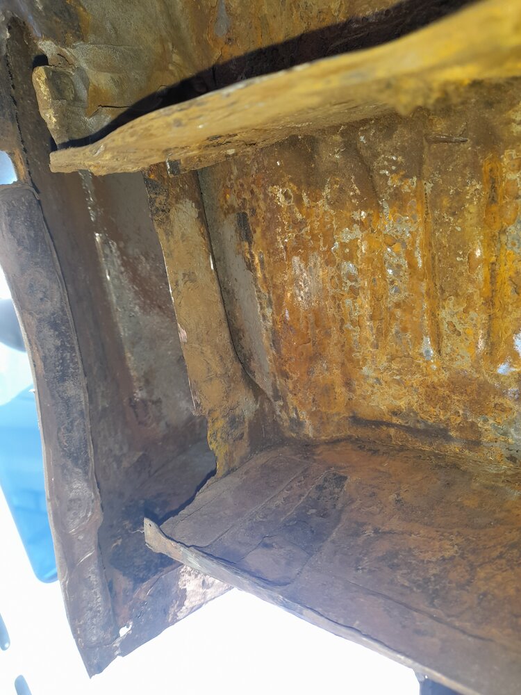

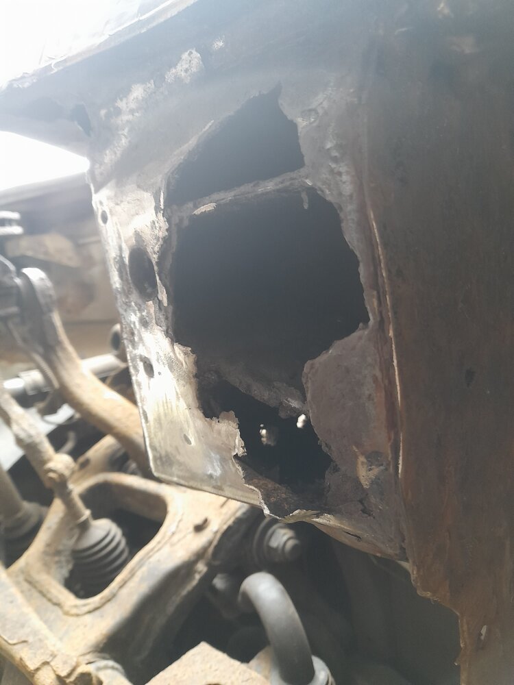

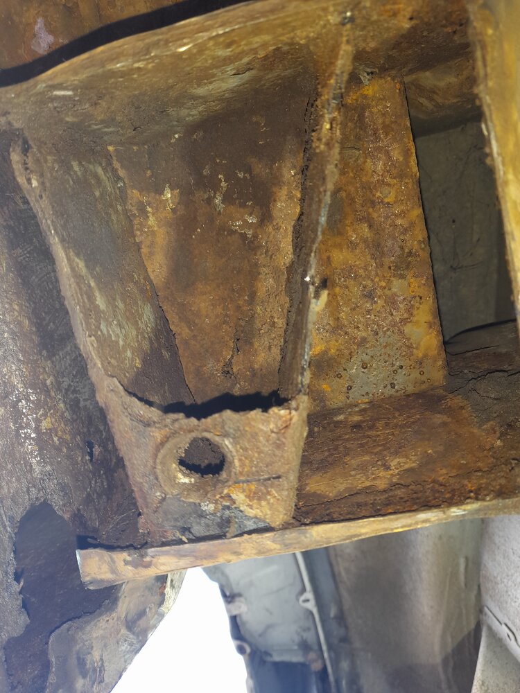

Got the trim & inner wing plastic off- its amazing how much crud gets in behind! Nothing to scary revealed, though the panel/side of the jack box facing the f wheel, and opposite does have a bit of rust. Could be a lot worse.

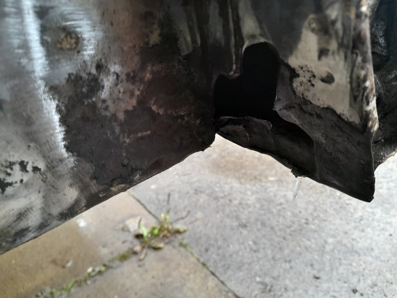

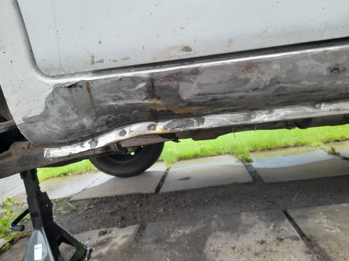

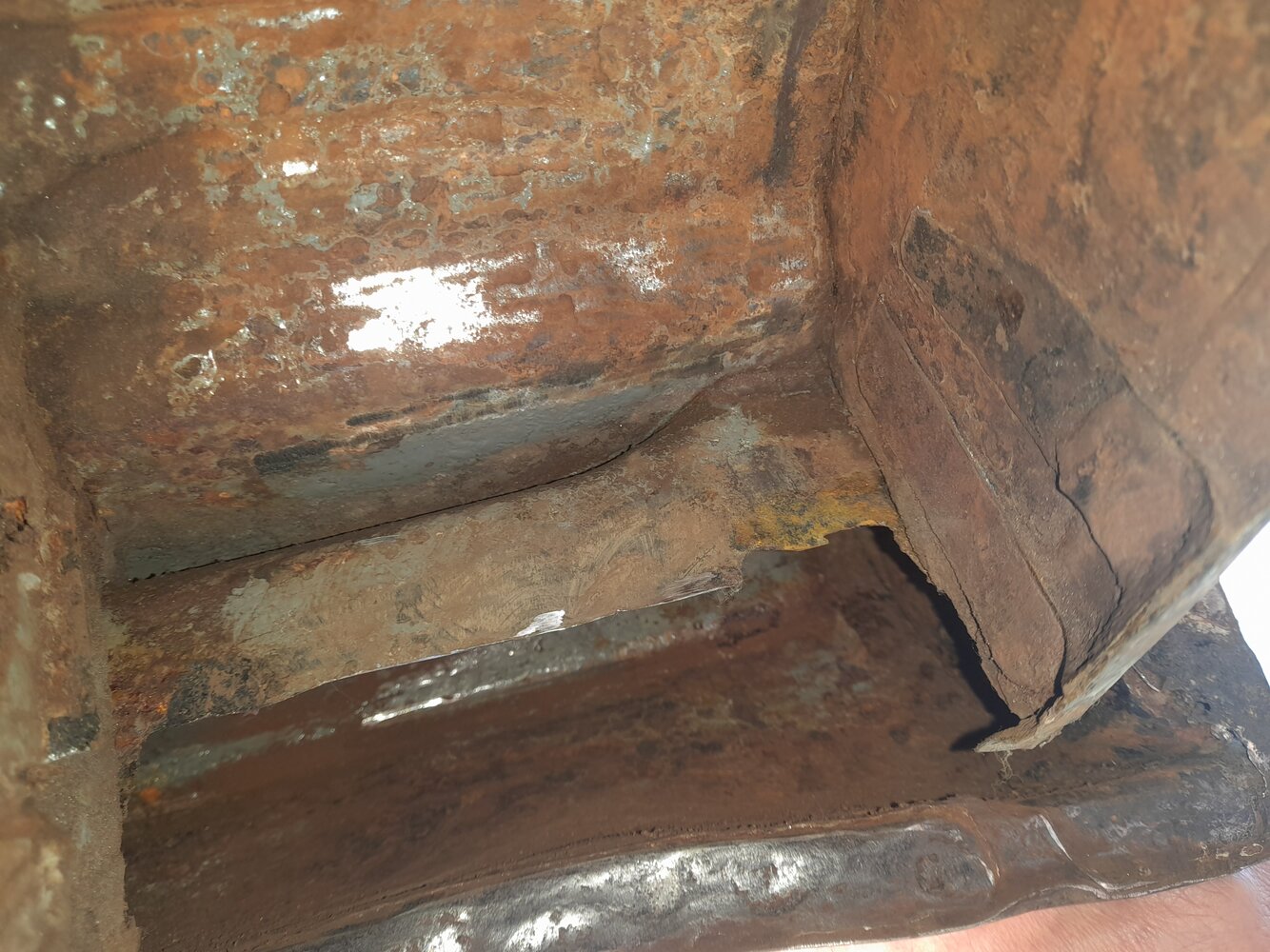

Angry grinder & flap disc, plus some B&D Powerfile waving has got me this far. Outer sill a pit of pitting and one bit by the seam that's not ideal, but not too bad.

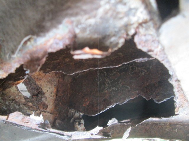

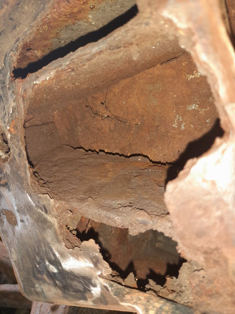

Inner sill close to the wheelarch I developed a small hole, while the foot of the jacking point & its internal structure looks a bit sad.

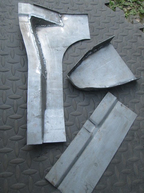

I'm not expecting to do an A1 job, cos I'm simply not good enough or practiced enough - but I'm hoping to make a solid repair.

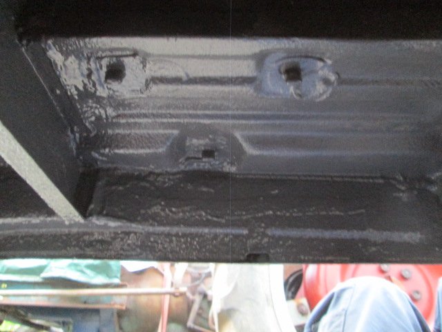

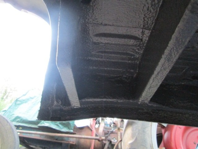

I've bought a gallon of white Jotamastic 90 to coat everything with after my trademark iffy metal bashing & glueing. Never used the stuff before, but mix small quantities up & brush on is the plan, & fingers crossed!
