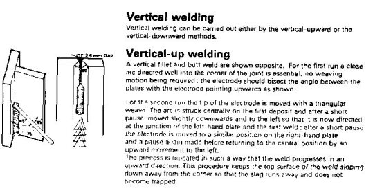

Not an expert welder just DIY really and I can weld a decent run on the flat etc, who cant?
I am trying to Arc weld some rope hooks onto the chassis of a trailer and can not get a decent weld, I do not know how to weld vertically, any hints would be appreciated.
