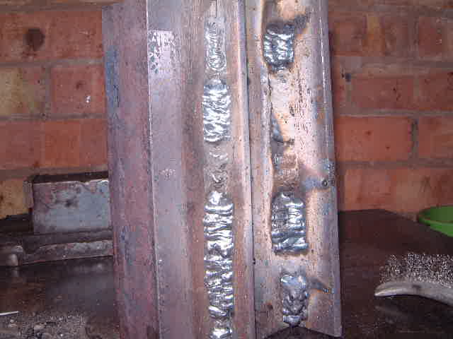

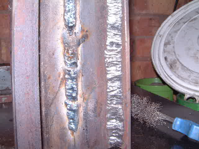

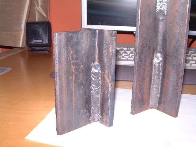

New welding vertical pictures( progress )

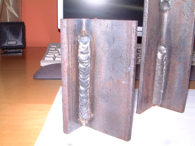

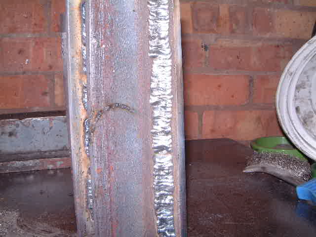

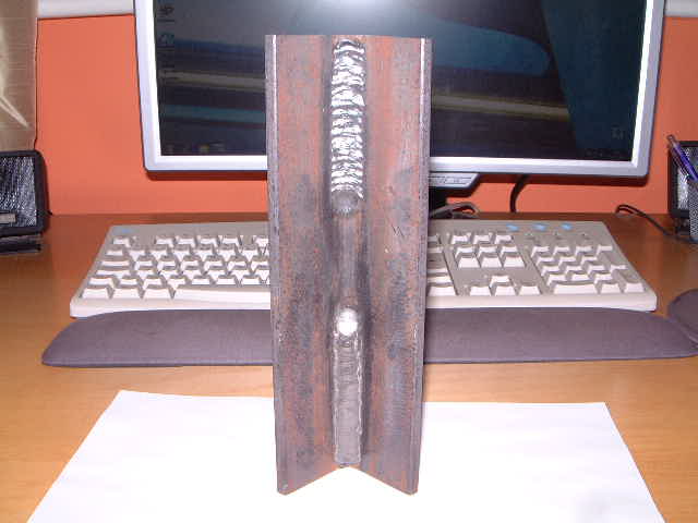

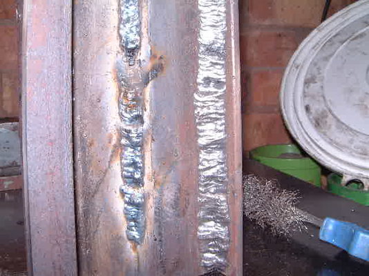

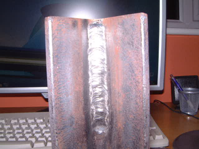

Ive tried putting the rod in at 95deg to 100deg which is much better at
keeping the slag out the way which lets you see the puddle, this has helped
me a lot, ive also tried low hydrogen 3.2 rods which is the smoother weld in
the pictures,
things seem to be going in the right direction, cheers all ocean
