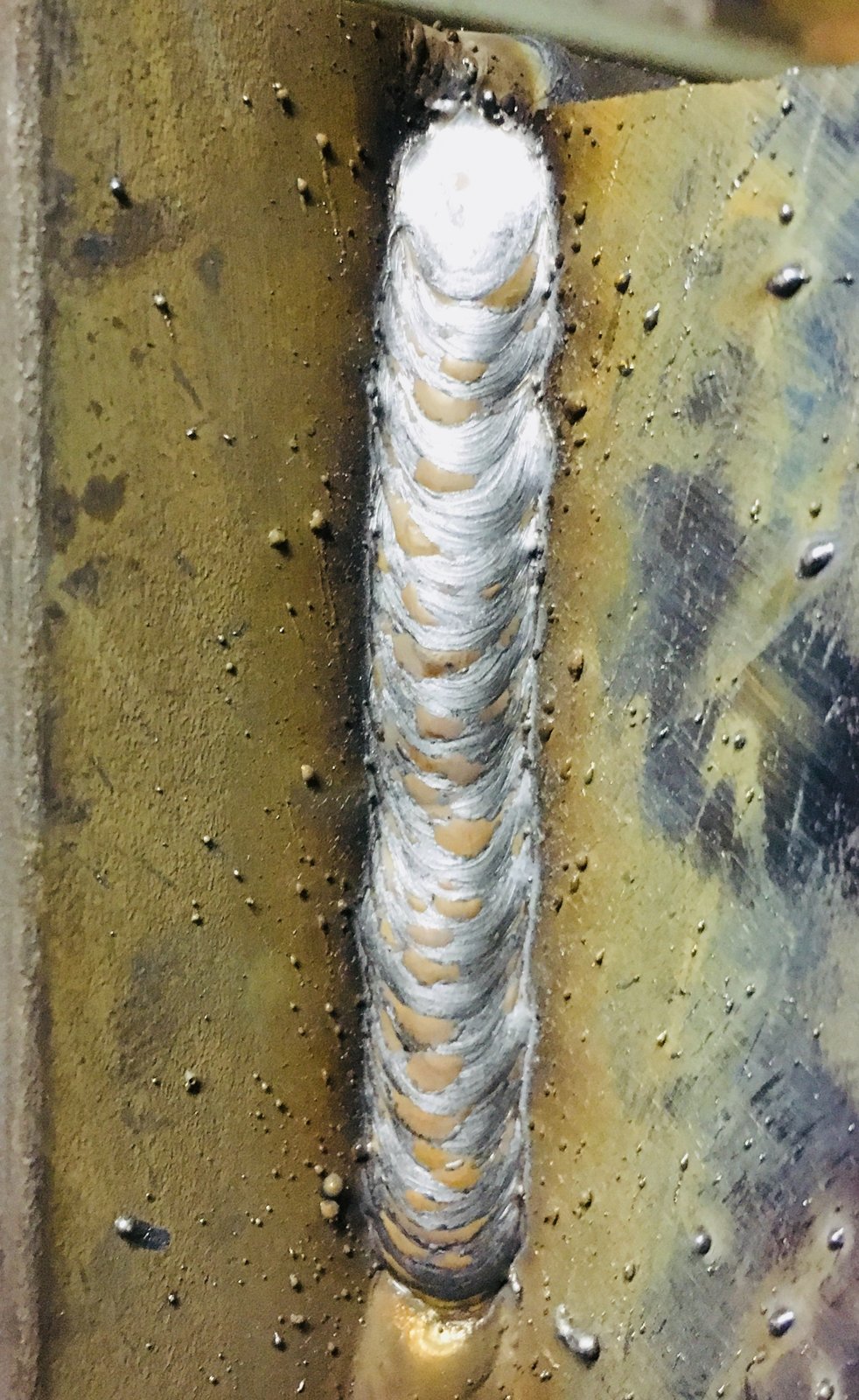

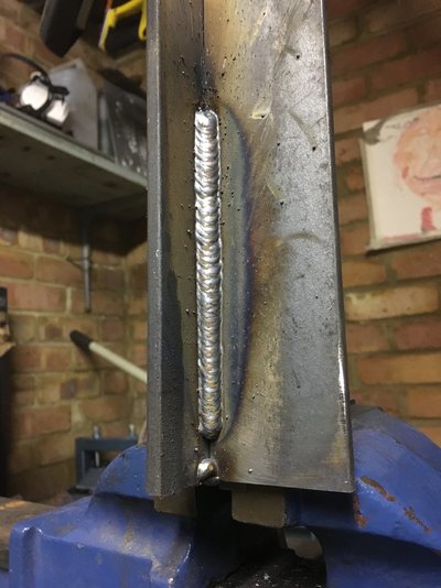

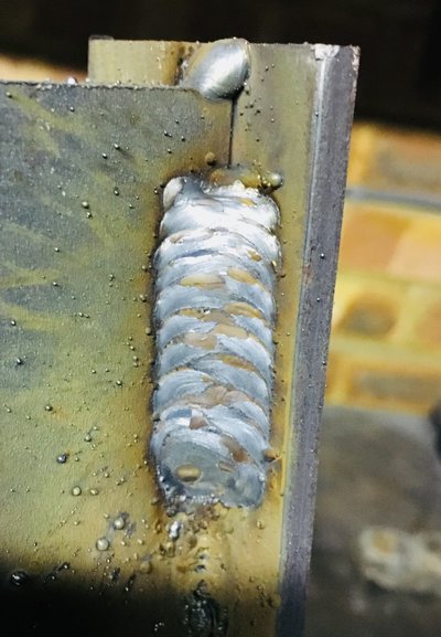

It will give you an idea of settings I suppose before gravity makes things go south but tbh the absolute best way to learn is an open root.Does practicing V up mig with simple beads on a flat work piece serve any purpose?
Closed joints will always appear to weld cold. It’s dip transfer on thick plate so it’s never really going to blend and flow like an open root will.
