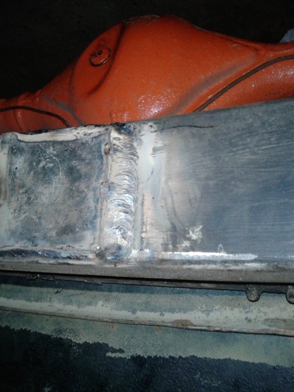

Hey guys scarry news I get married next week so no welding practice for me for a while but I will be back next year hopefully with some better welds :-)
Any ways here it is
Nexus rods 3.2 7018
Amps 130
Thermal arc 175 machine
Easab globe arc mask
Hey guys thanks for the comments trying to become an all position welder trying to get enough practice.
It is vertical up just my phone rotates everything the opposite to what I want
Hi Mate,
Try out the comet J50 7016 rods. There awsome to weld with (bit of a bugger to strike) but once they are going they weld like a dream. Make sure you bake em first and they have a re-meltable slag so chipping off on re-starts. You do have to get the slag off on root runs though.
