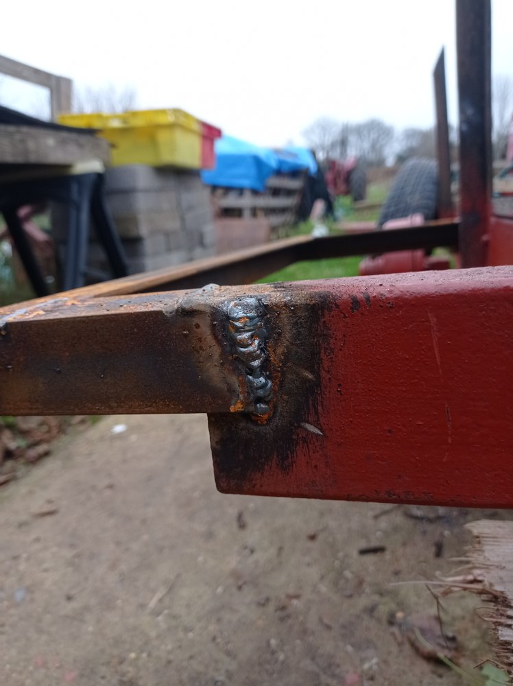

I don’t think the fronius should get all credit there trigger. Look at those lovely edges oof! Smart job there.another one with the fronius

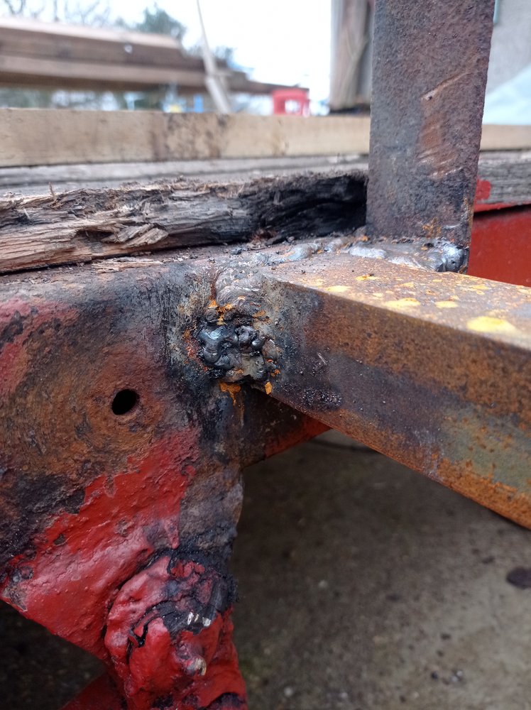

Frodo?the fronius just welds different. its like theres magic inside or something![]()
Was that with a 6013 rod?another one with the fronius
£2700 of something! It would be fascinating to see the same weld made with an oil-filled or buzz-box so we can see what difference is made by the machine rather than the operator.the fronius just welds different. its like theres magic inside or something![]()
ill tell you a few advantages of pulse stick on uphill since some people dont know anything at all about it.
typically its faster as no manipulation is needed. less heat in the part so less distortion which can be verified with straight edges and thermal guns. less chance of undercut. and it just looks better if you ask me.
you can debate all day about which types of welding require more skill than others but ive no desire to involve myself in that.
im not saying pulse is the be all end all for every situation. just saying its a nice thing to have in the tool box. only a foolish person would let such a good tool go unused
