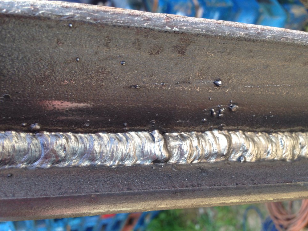

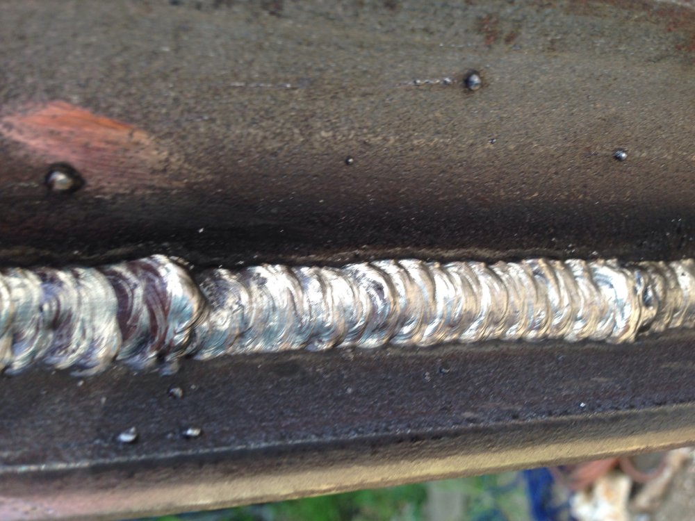

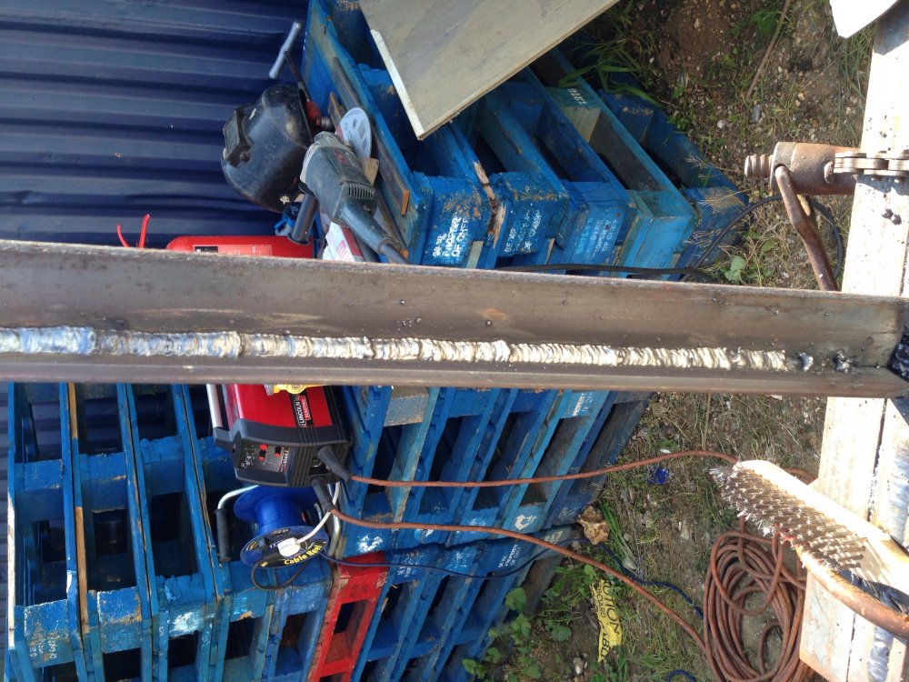

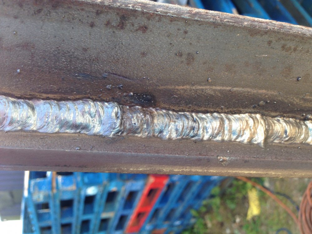

Here is a weld I have just completed its a mma vert weld on 10mm plate I put a root stringer on first with a 2.5 6013 rod on 85 amps first then capped it with a 3.2 6013 rod on about 95 amps.....any comments or advice will be greatly appreciated
