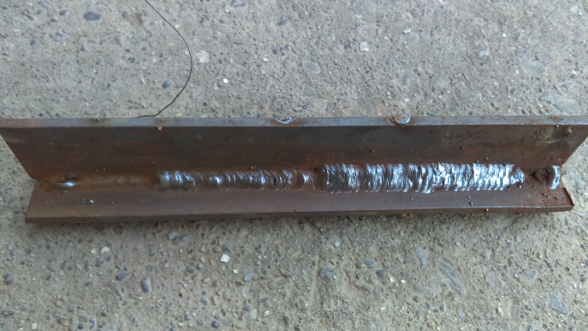

Okay thank you, I used 3.2mm 6013 rods at 85-90 amps
Very nice, Oisín
Are you using INE “blue” 6013? Those rascals run best electrode negative; you may be doing so, of course.
Michael
I have been some blue INE rods on ac recently, lovely. About 98% were peeling/breaking the slag, don’t think I did any bad welds. Downhand, vertical and overhead work.
